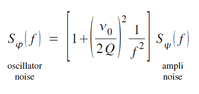

Again. you are all mostly talking about the Leeson effect which is quite subtle; I can almost guarantee that none of you will be able to figure it out if you haven't
heard of it before.
The relationship between the oscillator noise and the amplifier noise (assuming the amplfier is the only noisy component in the circuit) is
Equation S_φ(f) = [1 + (ν0/(2Q))^2 · 1/f^2] S_ψ(f), with S_φ(f) labelled oscillator noise and S_ψ(f) labelled amplifier noise.
(sorry was too lazy to do this in Latex)
Note the effect of the Q . The shape of the spectra will depend on the frequency (essentially whether the phase fluctuations are fast or slow) and the quality factor of the resonator (v0/2Q, also known as the Leeson frequency).
People get this wrong all the time; I know of multiple peer-reviewed papers where they've failed to take the Leeson effect into account and have ended up with incorrect results.
