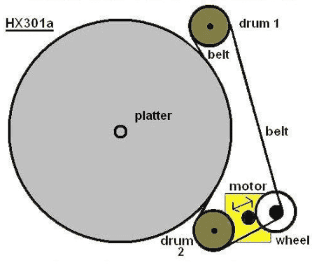

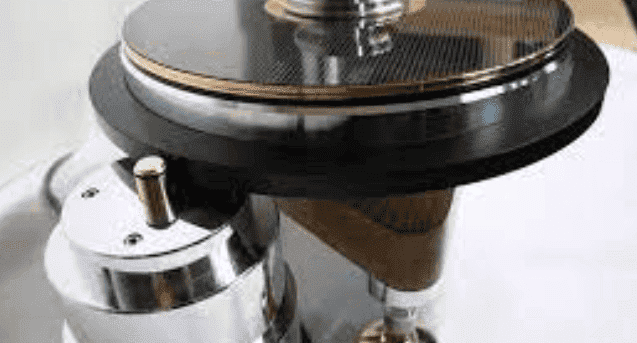

As I am building this product, I am now finding the different things that I am incorporating to it. I've added a speed controller but I really need the proper motor to use. I have a DC 100w scooter motor I'm going to use, I was told that it had 0.34 Torque, and I wanted to know if I'm on the right rack with the motor I purchased?
Will you attach the motor's shaft directly to the turntable shaft? Or will you use something like this belt drive?
Or perhaps one where the motor shaft rubs against the turntable rim?
Key parameters are turntable RPM? motor RPM?
