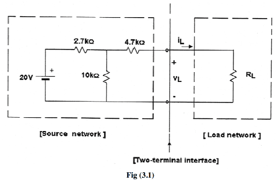

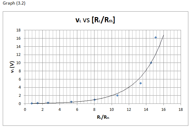

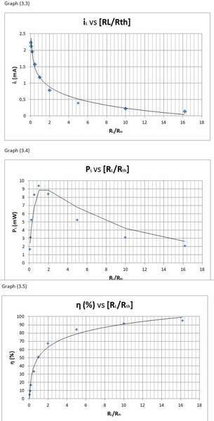

What is the range of values for [RL/RTH] that provide a combination of “almost” optimum power transfer to the load at a reasonably high power-transfer efficiency?
What are they asking for in this question? What do they mean by optimum power transfer? We replaced the source network with the thevenin equivalent.

Also, I don't understand how load power and source power are not the same. They both have same voltage (VL and IL).
Attached is the equation for efficiency.

Load power and source power are the same only if the load resistance equals the source resistance.
This is a weird question indeed. "Almost"? "Reasonably high ..."?
The optimum ratio for max. power into the load is when RL/RTH = 1. RTH is fixed.
What did you get for RTH?
