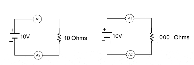

OK have a look at these circuits I have drawn ...
one is a 10 Ohm resistor the other a 1000 Ohm resistor
4 questions for you to answer
1) what is the voltage at the top of each resistor ?
2) what is the voltage as the bottom of each resistor ?
3) what do those answers tell you about what happens to the voltage across the resistor ?
4) what is the current flowing through each resistor ? ( use Ohms Law to solve)

Thank you for a great answer, really appreciated. I don't think I fully grasp it though, excuse my ignorance. If the resistance cannot become greater than the voltage source, what would happen if I were to cram a thousand 10 ohm resistors on a 10 V circuit? Would the voltage drop for each resistor be the same, and would it be -0.001*1000*10? And if the resistors have different resistance, does each resistor drop the voltage to a value that corresponds to its resistance?
I tried answering your questions:
1) 10 V
2) 0 V
3) The total resistance drops the total voltage.
4) 1A and 0.01A
This raises two more questions for me though:
1. right after the resistance, there is 0 voltage and 0 resistance in the circuit. That gives an impossible value for the current no?
2. Why does the electrons want to finish the circuit if there is no potential left?
Is the current right before a resistance higher than after the resistance? Again, excuse my ignorance on the topic.

that hilited bit doesn't make sense ... you can have a resistance of any value, into the millions of Ohms say a 22 MOhm (22 million Ohm) resistor
no ... now here comes a variation of the circuits I have shown above. with multiple resistors they can be arranged 2 ways ( or combinations there of)
1) series connection ... one resistor following another or 2) parallel connection resistors connected side by side
I will do a separate post describing those
1) 10 V
2) 0 V
4) 1A and 0.01A
well done ! :smile:
3. Is the current right before a resistance higher than after the resistance? Again, excuse my ignorance on the topic.
1) ... no its not its just the point in common with the negative ( 0V) terminal of the battery or other power supply ... there needs to be a complete circuit from positive to negative (or visa-versa) for current to flow
2) ... The electrons ( since you used that term) flow from the negative (0V) terminal to the positive terminal ( conventional current flows the other way ... we won't get into that at the moment ... let's just assume the use of conventional current flow from positive to negative OK )
3) no it isnt
Dave

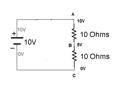

Ok let's look at series resistors across a voltage source
now this is a real easy one as the resistor values are the same
you can see that the 10V supply drops by 1/2 across each resistor ... ie a 5V drop across each one for a total of 10V
1) say the resistor values were different the top one 10 Ohms and the bottom one 100 Ohms, what then ?
then we approach it slightly differently we work out the current flowing in the circuit and with that info work out the voltage drop across each resistor
this is where your last question ... 3. Is the current right before a resistance higher than after the resistance? comes into play
the answer I gave was ... no, it isn't ... for a DC series circuit the current flowing is the same everywhere in the circuit
ie. in that top section of wire between the + terminal and the top of the first resistor ( at A), in the section marked as B and in the section from the bottom of the lower resistor, from C back to the negative terminal.
2) So, how do we work out the current flowing ? again use Ohms Law just like you did in the first circuit above ... I = voltage / total resistance
have a go and post your answer
