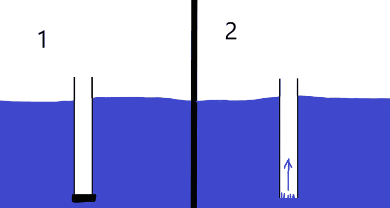

abrek
TL;DR
if you take a pipe with one end closed and lower it into the water to a great depth, for example, 1OOO meters, after which we open the closed end, the pressure difference will drive the water through the pipe and then to the surface will you get an endless fountain?
No, the pipe will fill to the surface of the water. It will not shoot out of the top of the pipe in an endless geyser.
What drives the water inside to go up the pipe is the pressure difference between the level of the water inside and outside. When these levels are equalized, there will be no such pressure difference.
Welcome, @abrek !
You will get a temporary fountain, not an endless one.
You can't get more pumping work out than you put in by forcing the pipe down against its natural buoyancy.

thanks for the reply. I thought this was possible due to the large difference in pressure at the bottom of the ocean and the usual pressure at the surface

You probably get some oscillation in which the water could spill out if the top momentarily, but it will not be constant, and will die out from friction/viscous effects.
Out curiosity I come to this ODE,
$$ g ( H - h ) - \frac{v^2}{2} = h v \frac{dv}{dh} $$
or with ##u = \frac{v^2}{2} ##
$$ h \frac{du}{dh} + u -g (H-h) = 0 $$
Can we tell if this equation will produce a reasonable solution. I would like to say at ##h= H## we get:
$$ h \frac{du}{dh} = - u $$
implying that ##v^2## is still decreasing there (the beginning of oscillation), but can ##v^2 = 0 ## @ ##h = H## be ruled out?
I'm also concerned that there is no mass at ##h = 0## implying infinite acceleration there. Perhaps some mass must be included around the inlet if this is too fishy. But then my question is; if so, how much?
abrek said:
TL;DR Summary: if you take a pipe with one end closed and lower it into the water to a great depth, for example, 1OOO meters, after which we open the closed end, the pressure difference will drive the water through the pipe and then to the surface will you get an endless fountain?
Have you never used a drinking straw? If it doesn't work there, why should it work with 1000m? The pressure difference increases at the same rate as the height the water has to climb.

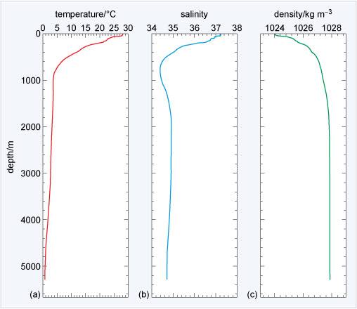

It is also important to note that the water flowing up inside the pipe will be colder and denser than the water outside it.
@abrek,
Would that fact make your fountain effect stronger or weaker?
It is, to start off with but, when the water level in the tube reaches the surface level, the weight pushing down is equal to the buoyancy pushing up.
But, don't despair : fresh water is lighter than sea water, so...
If you stick a seawater-RO filter assembly onto the bottom end of your 11km long pipe and mosey over to the Challenger Deep, you could make a 90ft high fountain of fresh water in the middle of the Pacific Ocean.
