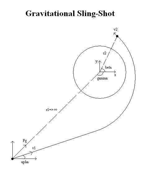

Hi!
I wonder how it is possible to accelerate a satellite using the gravity of a planet?
My amateur calculations would go like this:
Simplifying and considering a straight forward approach towards the planet where the end distance to core is r2 which of course will be grater than the planet radius which we may call R.
Using the basic fact that speed is the integral of acceleration we may (perhaps) write
[tex]\Delta v=-a_r\frac{1}{m} \int_\infty^{r_2} Fdr[/tex]
and while
[tex]F=\frac{mMG}{r^2}[/tex]
this means
[tex]\Delta v=-MG\int_\infty ^{r_2}\frac{1}{r^2}dr=\frac{MG}{r_2}[/tex]
Is this right?
I would however much more like a formula for the actual trajectory and I would very much like to try to derive it myself. But I need help.
First, what kind of coordinate system should I use?
I was thinking of cylindrical coordinates.
And there will be three angles. One for the gravitational force (gamma) and one for the speed direction of the vessel (alpha) and one for the release of the vessel (beta).
What do you think? Is it possible to derive the change of speed and beta using this?
I am attaching a drawing of this thought.
Take care!
Roger

That is not the right way to look at a gravitational sling shot maneuver. You did not account for the fact that the planet orbits the Sun. The primary purpose of a gravitational sling shot maneuver is to change the speed of the vehicle. You are not going to see that change in speed by looking at things from the perspective of the planet and vehicle. You have to look at it as a three body problem.
Suppose a vehicle is in deep, deep space, far removed from any gravitational influence except for a single rogue planet. If the vehicle swings by this planet on a hyperbolic trajectory, the vehicle will have a different velocity vector after the encounter than it did before, but the magnitude of that velocity vector will remain unchanged. You only get a change in speed if the planet itself is undergoing acceleration.
The interaction between the planet and the satellite is the Kepler problem. It needs some analysis to solve it, but it is possible.
That is not the main idea of a gravitational slingshot, however. The initial and final velocity relative to the planet is always the same, this follows from energy conservation. Slingshots use the fact that the planet orbits the sun - so while the speed relative to the planet stays the same, the direction changes, and therefore the speed relative to the sun can change.

As the satellite passes "behind" the planet, the component of gravitational force along the path of the planet results in the planet being slowed by a tiny amount (relative to the sun), and the satellite's speed being increased by a great amount (relative to the sun). During the times when the satellite is "ahead" of the planet, the satellite is much further away, and the gravitational force much less, so the net effect is to slow the planet and speed up the satellite (relative to the sun).

Hi!
I have tried an energy approach to my problem and I actually think I got something :smile:
I think we may write the total kinetic energy equations like this (skipping /2 for simplicity):
[tex]mv_1^2+MU_1^2=mv_2^2+MU_2^2[/tex]
Where
v1 is the incoming speed
v2 is the outcoming speed
U1 is the planet speed before the approach
U2 is the planet speed after the approach
Putting
[tex]v_2=v_1+2U_1[/tex]
gives
[tex]mv_1^2+MU_1^2=m(v1+2U1)^2+MU_2^2[/tex]
and solving for U2 yields
[tex]U_2=\sqrt{U_1^2(1-4\frac{m}{M})-4\frac{m}{M}U_1v_1}<U_1[/tex]
What do you think?
I am however a little confused because I have not used any potential energy.
Roger
Potential energy is negligible both before and after the slingshot.
This looks like a correct approximation for the scenario.
Most slingshots don't include a 180°-turn, so the satellite gains less energy.
