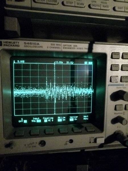

VolBog
Good day.
Resently, I bought the Hamamatsu R928.
But when I connect to power suply and connect output to the osciloscope I have strange signal.
Maybe someone know the origin of this signal?

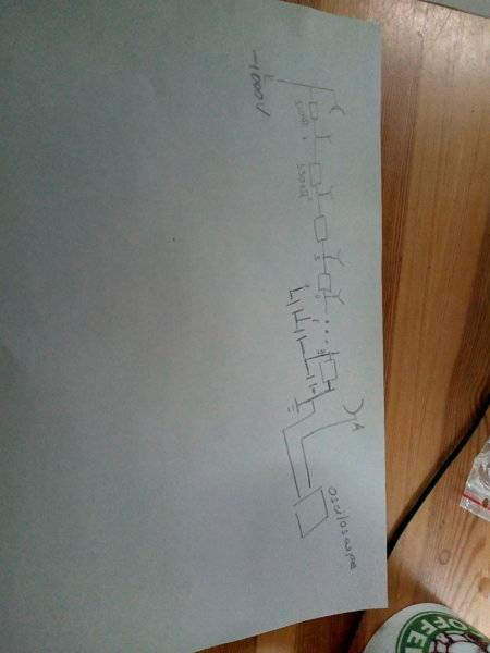

Is it covered or open? What kind of fixture are you plugging it into? Can you post your schematic?

It is open (if you about black cover which usually add to reduce noise).
I use standart D type socket assembly E717-63. And connect to osciloscope directly (the input impedance 1MOhm).

What are vertical scale and timebase on that 'scope trace ?
In other words - what do we know about your "noise" ?
120 hz would likely be nearby fluorescent lights.
So far it looks like common EMI from an SMPS nearby.

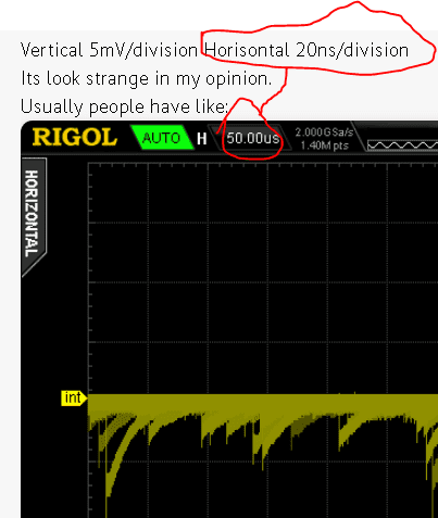

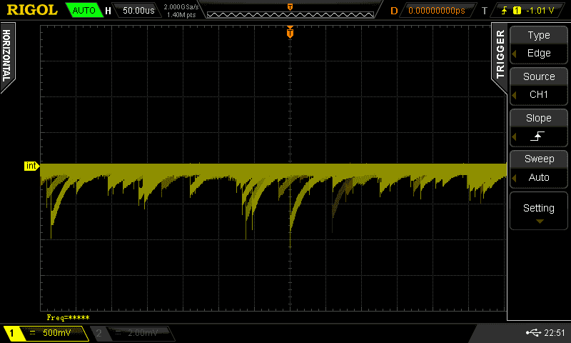

Vertical 5mV/division Horisontal 20ns/division
Its look strange in my opinion.
Usually people have like:
But in my case in this pmt I can't see any signal.
Maybe I have broken pmt?

what does yours look like at those people's settings?
