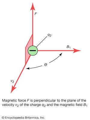

The magnetic field is an effect induced by a moving charged particle or electric current, the flow of charged particles (protons or electrons). The magnetic field exerts a magnetic force on any other moving charge or current present in the field.
So let's say you have a moving charge ##q_1## and another moving charge ##q_2##. As ##q_1## moves with velocity ##\vec v_2##, it creates a magnetic field ##\vec B_1## in its surrounding vicinity (where ##q_2## is also present) which in turn exerts a magnetic force ##\vec F_{1,2}## on ##q_2## (as ##q_2## is also moving). These can all be put into an equation, $$\vec F_{1,2} = q_2 * \vec v_2 \times \vec B_1$$
This is the same thing as $$\vec F_{1,2} = q_2 * \vec v_2 * \vec B_1 * sinθ$$
##\vec v_2##, ##\vec B_1##, and ##\vec F_{1,2}## can all be represented as geometric entities in three dimensional space, or vectors; vectors are described by stating their magnitude and direction.
(image taken from Encyclopaedia Britannica)
θ is the angle between ##\vec v_2## and ##\vec B_1##. In the above picture, θ = 90° because ##\vec v_2## and ##\vec B_1## are perpendicular to each other (the angle between them is 90°).
