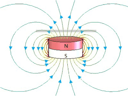

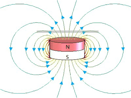

1. I did use g as a constant. I know that opposing force exists, but I thought it could be negated. The magnet appears to be in freefall the whole way through the tube.
2. I know the orientation of the magnetic field coming from the magnet. The tube I dropped it through is too narrow for the magnet to be in any position but upright. Its essentially a bar magnet falling straight down. Either north end straight down or south end straight down. The magnet definitely doesn't have too much wiggle room as it makes it way down. By strength I mean determining B. Anytime I've purchased magnets they are usually labeled with "Field strength at surface". I know I'm not measuring at the surface, but I didn't expect the numbers to be so far off.

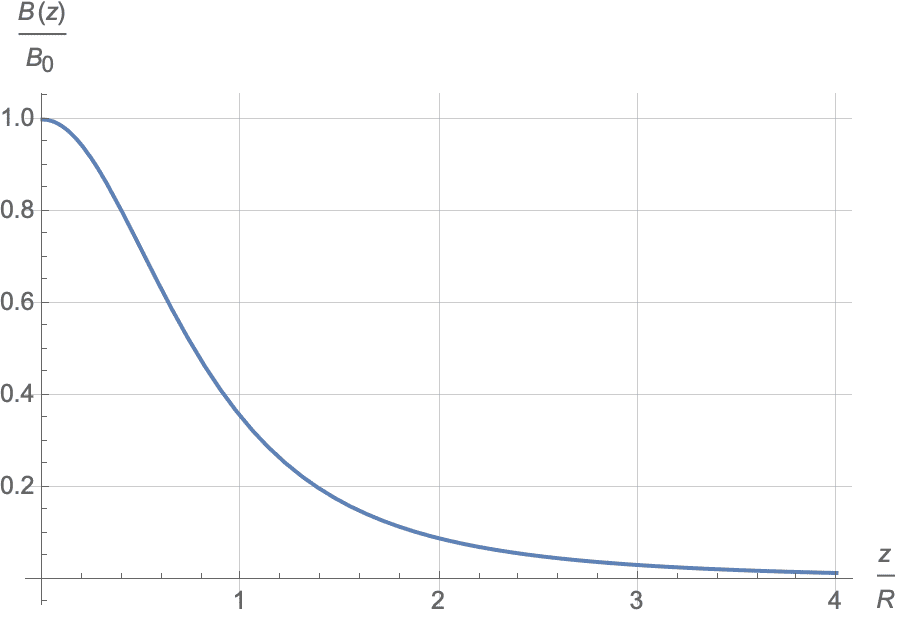

The field at some distance ##z## from the magnet, ##B(z)## varies as ##1/z^3##. The plot below shows the ratio ##\frac{B(z)}{B_0}## plotted against distance measured in disk radii. Here ##B_0## is the maximum field at the surface. You can see that at distance equal to a disk diameter (##\frac{z}{R}=2##) the field is about 10% of the surface field. You may not expect the numbers to be far off, but they are.
