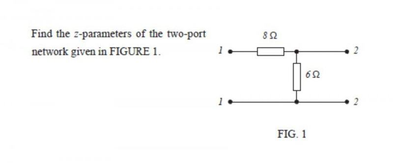

acw260
As above.
(z11) With the output open circuit (and therefore I2=0) z11 = V1 / I1 = (R8 + R6)I1 / I1 = 14ohms;
(z12) With the input open circuit (and therefore I1=0) z12 = V1 / I2 = R6 = 6ohms;
(z21) With the output open circuit (and therefore I2=0) z21 = V2 / I1 = V1 x (R6 / (R8+R6) ) x ( (R8+R6) / V1) = R6 = 6ohms;
(z22) With the input open circuit (and therefore I1=0) z22 = V2 / I2 = R6xI2 / I2 = R6 = 6ohms
Is the above correct? It seems so easy that I'm worried I've overlooked something and made a really basic mistake!

z11 = V1 / I1 = (R8 + R6) I1 / I1 = 14ohms
The formulae come from applying the z-parameter equations characterising a 2 port network.
For z11 assume that the input is not open circuit. Therefore I1 is not equal to zero. I1 then cancels out from the equation leaving z11 = R8+R6. You don't need a value for I1, just that it doesn't equal zero.
For z12 again it doesn't matter what value you have for I2. You show that z12 = R6 = 6ohms. The value of I2 becomes irrelevant.

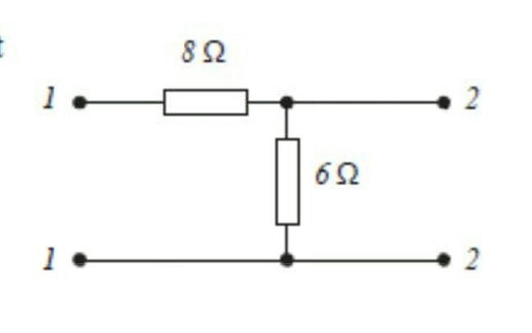

So as I understand this ##Z11## is the impedance seen looking into port 1 when port 2 (output) is open
Output is open circuit so ##I2=0##
##Z11=\frac{V1}{I1}=\frac{(R8+R6)(I1)}{I1}## The ##I1## cancels leaving ##R8+R6=14\Omega##
So for ##Z22## is the impedance looking into port 2 when port 1 (input) is open
Input is open circuit so ##I1=0##
##Z22=\frac{V2}{I2}=\frac{(R6)(I2)}{I2}## The ##I2## cancels leaving ##R6=6\Omega##
The reason ##Z22## only has ##R6## to deal with is because looking into the network from port 2 we can only see the ##6\Omega## resistance

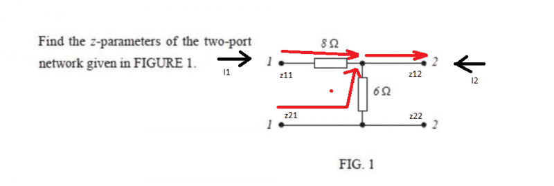

So for ##Z12## i understand this is the ratio of the voltage at port 1 to the current at port 2 when port 1 is open. If port 1 is open the ##I1=0##
You have used the equation ##Z12 =\frac{V1}{I2} = R6 = 6\Omega##
My question is why does ##V1=6\Omega## this time whereas when for ##Z11,V1=R8 + R6##
Thanks
Inject current at top terminal 2 and it exits at lower terminal 2. With port 1 open, determine V1.
Does this answer your question?
So current will flow through ##R6## and back out via the lower terminal 2 because port 1 is open. So R8 does not come into the equation so to speak??
I have a better understanding of this now, yes. Thanks for the help

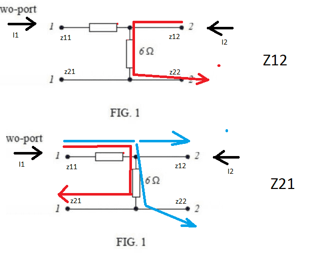

To try and understand the current flow path, I think I understand why Z12 = 6ohms as it passes only through the 6ohm resistor ( first crude drawing )
I would've though that Z21 = 14ohms as well as it would take the red path ( second drawing), can't quite understand why it is 6ohms unless it takes the blue path, meaning that the 8 & 6 are in parallel?
Right, the red path. Let's look at the red path.
So z21 = v2/i1 with i2=0. So I run a current i1 into the input, what's the output voltage with the output open?
Sorry, I assume you mean the red path in the second drawing? If so current would flow from top terminal 1 to bottom terminal one, so with both terminal 2s open the output voltage would equal the voltage across the 6 ohm resistor?
Wait, so would:
Z21 = V2 / I1 = (6 * I1) / I1 = 6ohms as I1 cancels out?
Then Z12 = V1/ I2 , the current would act as in the first drawing so V1 = I2 * Z
So:
Z12 = (Z*I2)/ I2 = (6 * I2) / I2 = 6 ohms
If this is the case then I now don't understand why Z11 is 14 ohms rather than the same as Z21 with 6, unless it is because from the perspective from Z21 the 8 ohm resistor is downstream of the 6ohm?

Well, you got z12 and z21 right.
So, let's re-examine z11: z11 = v1/i1 with i2 zero (nothing connected to port 2). You put in v1 volts, what do you get for the current?
BTW although I told you about z12 = z21, you shouldn't use that fact until you're comfortable with solving for them with the basic equations. It takes a while and you'd benefit from the double-check. And also BTW you may know there are several other two-port parameters, like yij, hij, aij. You should be able to find those from the respective equations also.
Okay so Z11 = V1 /I1 with V1 volts would mean that current = I1. I think I maybe understand now.
So Z11 = V1 / I1, voltage will run from top terminal 1 to bottom terminal 1 so will. = 14 ohms
However for Z21 = V2 / I1, V2 contacts will be in parallel with the 6 ohm resistor, so Z21 = (Z6+I1)/ I1 = 6 ohms Okay noted I'll try learn to use the basic ones first.
