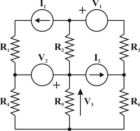

http://learn.lboro.ac.uk/file.php/1844/Quiz_figures/Chins_Files/Q11.jpg In the above circuit
V1=17 Volts
V2=8.5 Volts
V3=4.25 Volts
I1= 4 Amps
I2= 5 Amps
R1=4.25 Ohms
R3=6.375 Ohms
R4=1.0625 Ohms
R5=2.125 Ohms
R6=2.125 Ohms
Calculate the following:
a) Magnitude of the current through R5:
b) The resistance R2:
a) Magnitude of the voltage across I1:
I am really unsure on how to start this question, any starting tips would be great please, this was a tutorial set in my college class.
Have you looked at where the given voltage V3 is located? :))
what do you mean by that sorry?
You're wanting guidance to answer part (a)?
I think i know how to work out Part A - I am just guessing its Voltage divided by R?
Its part b and c, that i am stuck with
Guessing??
Can you work out how many volts across R4?
Hence, determine the current through R4 ... and so on, working your way around the circuit until you have determined all parameters needed to answer the questions.
Sorry I'm confused now. Would I need nodal analysis for this and convert all of these to current sources?
You do not have to convert anything, and you can do it step by step. There is no need for multiple unknowns at the same time. NascentOxygen showed you the first two steps.
Just use KVL to determine the voltage across R4.
Then use Ohms Law, KCL and KVL to determine voltages and currents one by one. No formal analysis and no need for a matrix of simultaneous equations!
