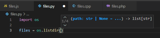

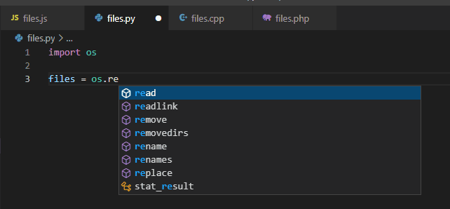

It is easier to learn when you have an IDE prompting you ... I will post an example later
I regularly write, review and test code in a number of different languages (Node.js/JavaScript, Typescript, Python PHP, C++...). I do all of this in Microsoft's free program Visual Studio Code because (i) it means I don't have the distraction of switching between different IDEs with different command sets and (ii) because of its astonishing rate of adoption among the developer community over the last 5 years it has plugins for every purpose a developer could want.
So how does this work in practice? Well let's take a simple example: I want to read the contents of a directory in Python. I know the function is in the os module, and I think it's os.readdir so I start typing...
No, obviously not, must be list... er, something, so I type 'li' and...
Oh yes, listdir, that's it. Now does this need an open directory handle or can I just pass it a string? Hit tab to select listdir and open a bracket and...
OK, a string is fine (it says this is 1 of 4 overloads so I guess I could use a directory handle as well) - and it also tells me it returns a list of strings which must be filenames. Great, let's print it out...

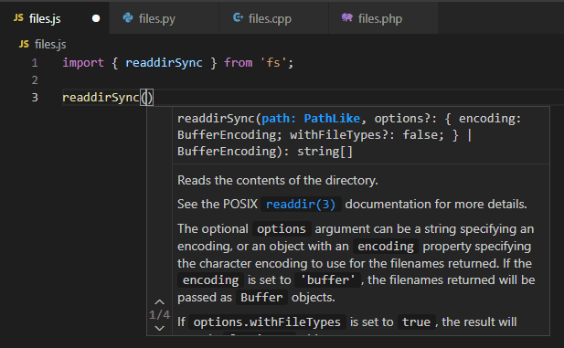

... ah yes, because Node is asynchronous by default (if you don't know what that means yet, don't worry) there are two alternatives: readdir and readdirSync. For this simple task I'll use the synchronous version but I could do with a reminder of how that works so again type readdirSync( and...
Great, I'm not sure what it means by a PathLike but I'll try a string '.'.
Oops, forgot to do a screen grab - but I think I've probably shown enough: if you are not convinced enough to give VS Code a try now (or if you only code in Python you will see similar functionality in PyCharm or, to a slightly lesser extent Spyder) you will never be.

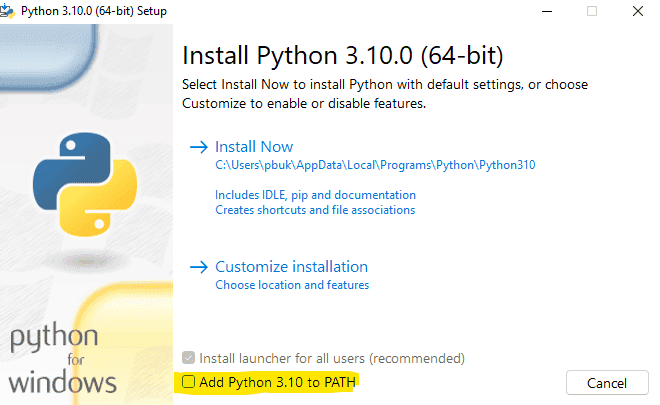

Hmmm, here are the trivial steps I have just taken to get to "Hello World" on a clean Windows 11 install:
  1. Download the installer from python.org and run it.
  2. Click the checkbox highlighted in the screen grab below - this is not checked by default and there is nothing to tell you that if you don't do this nothing will work.
  3. Select 'Install Now' rather than 'Customize installation' because we are going for the trivial route (and note that Python is going to be installed in C:\Users\pbuk\AppData\Local\Programs\Python\Python310 if I need that later, to set up as a Notepad++ 'run' option for instance).
  4. Download and install a text editor (I used to use Notepad++ so I'll go with that).
  5. Open a folder to work in and create a new text file 'hello.py'.
  6. Realise that the file I have created is actually called 'hello.py.txt'.
  7. Select View->Show->File name extensions so File Explorer stops getting in the way. Select Show Hidden Items as well otherwise that will probably throw me later.
  8. Rename 'hello.py.txt' to 'hello.py'.
  9. Right click on 'hello.py' and choose Open With -> Choose another app -> More apps -> Notepad++ and click 'Always use this app to open .py files'.
  10. Open 'hello.py', create my 'print("Hello World!")' program and save it.
  11. Open a terminal window to run the program: if you have done this before you get "Open in Windows Terminal" as an option on the right-click menu in File Explorer, otherwise you have to hit Start and select Windows Terminal (which defaults to PowerShell, although you can select PowerShell directly, or Command Prompt if you insist).
  12. Powershell will launch in your home directory; you could navigate to the folder you put hello.py in from there with cd if you know how, otherwise probably best to close this instance of PowerShell and open a new one using the right click option that should now be in File Manager.
  13. Enter 'python hello.py' to run your program... nothing happens.
  14. Realise that you need to reboot for the path settings to take effect, so restart (log off might be enough but to be sure...) - it would have been helpful for the installer to tell me to do this but hey-ho.
  15. After restarting, open up the folder, right click -> Open in Windows Terminal, enter 'python hello.py' and say hello to the brave new world.
  • Wow
