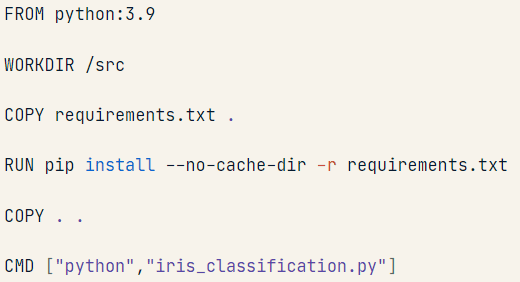

Hello,
anyone on Physics Forums using Docker? I have understood the overarching idea behind Docker (packaging code, dependencies, etc. into a container that can be shared across OSs) but I have some doubts:
I am confused about the base image line of code in the Dockerfile (which is simple text file): FROM python: 3.9
  • Why is that instruction called an "image"?
  • That first line line specifies the Python interpreter to use inside the container...Does that mean that when the container is built, using the instructions in the Dockerfile, a python 3.9 interpreter gets also downloaded and used into the built container?
  • Where does that specified interpreter get exactly downloaded from? When creating the docker container, the code and the dependencies are on my local machine....Is the Python interpreter instead downloaded form the internet?
  • The last instruction, CMD ["python, iris_classification.py"], specifies what to do at the command line to launch the program, i.e. type python followed by the name of the script, correct? Would it be possible to launch the program as a Jupyter notebook (ipynb) or does the code need to be in a .py file?
Thank you!!!!
Have you read the Docker documentation? It explains what an image is. See, for example, these pages:
https://docs.docker.com/build/building/packaging/
https://docs.docker.com/engine/reference/builder/
No, it specifies a base image that has that Python interpreter installed.
fog37 said:
  • ...Does that mean that when the container is built, using the instructions in the Dockerfile, a python 3.9 interpreter gets also downloaded and used into the built container?
No, it means that Python interpreter is already installed in the base image. That's why you use that base image instead of saying "FROM scratch" and having to manually do the installation of the Python interpreter yourself.
It depends on how that base image was built, which in turn depends on where you are getting that base image from.
Basically, yes. However, your invocation probably won't work because you are using the form that doesn't invoke a shell, but you don't give full paths to either the python executable or the .py file you are trying to run. See the dockerfile reference page I linked to above.
fog37 said:
  • Would it be possible to launch the program as a Jupyter notebook (ipynb)
I don't see why not if you installed all the required support for Jupyter notebooks with the appropriate dockerfile commands.
