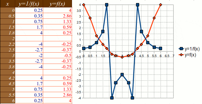

What is the critical point and location of this graph?

Do they mean 1/x? I'm not sure what they mean by 1 over f(x)
It seems to me I just have to answers questions based on the graph. From some reasons my answers are off compared to the answer book.
The questions are:
A) Find the critical point type f(x)
B) The location of f(x) critical point
C) The location of f(x) graph where it goes through the x axis, and the y-axis
A) Maxima
B) (3, -2)
C) (0, 0.25)
The function doesn't appear to go through the x axis.
Weird, the answer book says it's a min not and max. Apparently I'm wrong everywhere. Can anyone help me with it?

So by saying 1/f(x) they really mean 1/(some function)?

Ah...so we don't really know what the function is. But by looking at the graph we can deduce a lot of info. Can you help me understand what's wrong with my answers, though?
Okay, I showed that critical points of 1/f(x) are critical points of f(x), so there is a critical point at (3,-2). As we move away from this point, the function 1/f(x) becomes more negative. At the critical point f(x) has the value -1/2. If we move out from the critical point there will be a point at which 1/f(x)=-3 and so f(x)=-1/3, so we have to ask ourselves is what is bigger, -1/2 or -1/3?
For c) you have given the point where 1/f(x) hits the y axis. For hitting the x-axis, f(x)=0 at this point, what will 1/f(x) be?
The graph you have is of the function 1/f(x).
The graph you need is of the function f(x).
I would suggest you try to draw the graph of f(x).

I'm trying to follow you but I still don't see a function in all that, I just see a graph of a supposed existing function that isn't given to me. I'm very confused. Maybe my calculus gaps are too deep to understand? I thought I'm supposed to be given a function, something like X^3 -16x +33. Here I don't see a function, it just says "here is a function but we're not going to tell you and here's its graph"... this is very confusing. Sorry if I can't relate to your answers. Thanks for trying though.
The function 1/f(x) as drawn seems to diverge to -infinity at the points x=2 and x=4, so that would indicate that at those points f(x) must be zero, so you have two zeros of f(x) right there.
Giving you the graph gives you the function- at least to the accuracy at which you can read the graph. There is no "Calculus" required here, only the ability to read a graph.
At a number of different "x" values, you can read the corresponding "f(x)" from the graph. Use that to find 1/f(x). Mark the point (x, 1/f(x)) for those same "x" values and then draw a smooth curve through them to sketch the graph of y= g(x)= 1/f(x).
For example, f(0)= 0.25 so g(0)= 4. The point (0, 4) is on the graph of y= g(x). f(1) looks to be about 3/4 so g(1) is about 4/3. Marking the point (1, 4/3) won't be far wrong. It looks like f goes to infinity as x goes to 2 so g must go to 0 there. Mark (2, 0) on the graph of y= g(x). Similarly, f(3)= -3 so g(3)= -1/3. f goes to infinity as x goes to 4, so g(4)= 0. f(5) is about 3/4, again, so g(5) is about 4/3, f(6)= 1/4 so g(6)= 4.
Or are you given a graph of y= 1/f(x) and asked to graph y= f(x)? If so, just swap "f" and "g" in what I said above. The idea is the same.
Let me see if I can make it a bit clearer.
I've created the following table and figure to explain:
The table gives a number of x-values and the corresponding y-values (blue graph), such that the corresponding graph looks a bit like the one in your problem.
The y-values are the ones that correspond to the y=1/f(x) graph which is given in your problem.
The third column contains the 1/y values of the second column (red graph), which will make them correspond to y=f(x).
Your problem asks for answers for the red graph.
Does this help?

Serena! Wow. Above and beyond. I never had anything handed to me on a silver platter like that. I'm... not used to being pampered like that. You're going to spoil me rotten sis :D
Thank you. And thanks to the others for the contributions, I'm coming to with this calculus (or non-calculus in this case) thing. I've spent now a good chunk of time rereading the replies and churning over this.
So in the chart,
X represents the number line
f(x) represents the graph of the function (blue graph) WITHOUT the 1 over that function, just the function itself
AND the result in 1/f(x) is actually the graph I'm looking for. Because that's what they're telling me in the question. So, this basically boils down to a reading comprehension question, right?
In that case:
A) Minimum
B) (3, -0.5)
C) Visually I can see it's 2 and 4, although by Serena's chart it's undefined.

Your answers are correct. :smile:
But I'm afraid you're switching the graphs around the wrong way.
The graph given in your problem is the blue graph. Your problem states that this is the graph of 1/f(x).
However, the questions are about f(x) of which the graph is not given (for which I made the red graph).
Now, as you can see the value for x=2 of the red graph is 0, that is, f(2)=0.
This means the value of the blue graph for x=2, is 1/f(2)=1/0, which can not be defined. As you see the blue graph has no point for x=2, although the graph goes up to plus infinity, and comes back from minus infinity.
