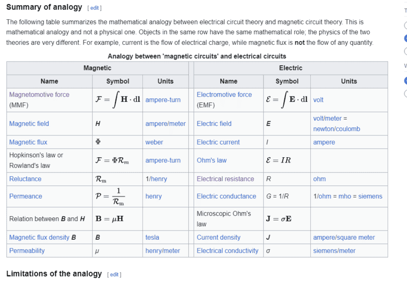

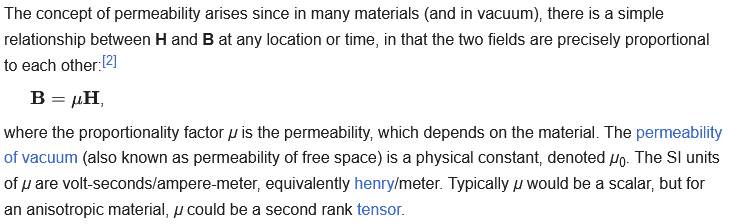

A week ago, I started studying electromagnetism. I was introduced to a few new concepts and one of them was H. Now, in my book, they defined H as just magnetic field strength and B as magnetic induction. The thing is, I don't understand what those terms really are (in a physical way), let alone the difference between them. I know how they are connected and I've read at least a dozen definitions and watched a few videos but they always somehow manage to go past the explanation.

You will get other better answers, but for me the easiest way to think about it is in terms of the magnetic permeability ##\mu##
https://en.wikipedia.org/wiki/Permeability_(electromagnetism)

It's actually a local book. I'm from Bosnia and Herzegovina so it wouldn't be of much help if I told you which book it is. For that reason, I'm just going to quote the book: B : "The quantitative measure with which we describe a magnetic field is the magnetic induction B."; H : "Strength of a magnetic field, unlike the magnetic induction, does not depend on the characteristics of the medium in which we have the magnetic field. Magnetic induction B and strength of the magnetic field are connected in this equation: ##B = \mu H##". Now this last definition is quite weird to me because it later on goes to say that for some materials ##\mu = \mu_r\mu_o## which means that it does depend on the medium in which we have the magnetic field (we use ##\mu_r## when we are not talking about vacuum so it doesn't make sense for us to say that it does not depend on the medium when it clearly does by this definition).

I would prefer to say that ## \mu = \mu_r \mu_o ## is always true. ## \mu_o ## is the permeability of free (empty) space and is always present. Some materials add their own factor, relative permeability ## \mu_r ##, which is dimensionless, like gain. This is really just a convenience in design so we don't always have to write out ##4 \pi \cdot 10^{-7} \frac{H}{m}##, which is ever present. Of course the "material" of free space has ## \mu_r = 1 ##.

Simply put, consider an iron bar inserted into a coil of wire and a current in the coil. The magnetic flux induced in the iron will have a flux density, B=phi/A, phi being webers of flux and A being the area of the bar. Note that the source current times the number of coil turns gives ampere-turns (F), the electromagnetic potential. Then the flux level times the magnetic Reluctance of the iron bar gives its ampere-turns drop, F=phi x R. From this H=F x R, where H is expressed in ampere-turns/meter. The HARD PART is that the reluctance is determined by BH data for the iron in an iterative computer routine or by calculus if by hand calculations. These fundamentals allow the calculation of magnetic devices to determine flux levels because the summation of all the ampere-turns drops equals that of the coil ampere-turns. Ultimately the flux level of the device (a series circuit) determines the energy in say a motor air gap, to determine its force or torque.
