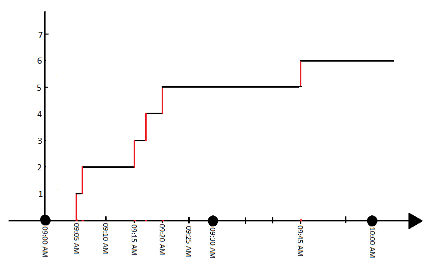

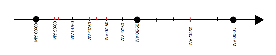

The above are some of the typical problems related to Poisson Process. I need to understand the difference between time, inter-arrival time, and arrival time in this regard.
Say, we start our counting from 9:00 AM and count up to 10:00 AM.
241879
Image-1: arrival process.
1. 1st call comes at 09:05 AM
2. 2nd call comes at 09:06 AM
3. 3rd call comes at 09:15 AM
4. 4th call comes at 09:17 AM
5. 5th call comes at 09:20 AM
6. 6th call comes at 09:45 AM
241880
Image-2: Poisson counting process
If (Nt)t(Nt)t is the Poisson process, what would be the values of tt?
What would be the time, arrival time, and inter-arrival time in this example?
As far as I understand:
* 1 minute, 9 minutes, 2 minutes, 3 minutes, 25 minutes are inter-arrival-times ##ρ_k##.
Are [0,5] minutes, [0,6] minutes, [0,15] minutes, ... etc time or arrival time?
