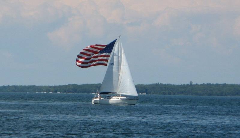

On a sail boat the flag orients down the apparent wind. At the height of the sails (like the big US one above) it's affected by the airflow diverted by the sails.
