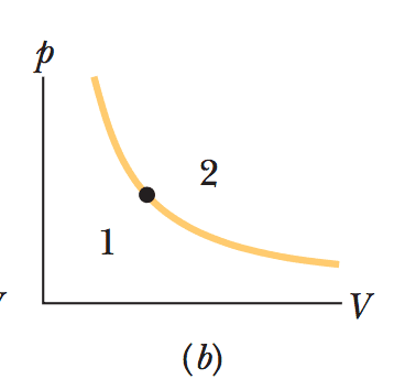

The dot in Fig. 19-18b represents the initial state of a gas, and the isotherm through the dot divides the p-V diagram into regions 1 and 2. For the following processes, determine whether the change Eint in the internal energy of the gas is positive, negative, or zero: (a) the gas moves up along the isotherm, (b) it moves down along the isotherm, (c) it moves to anywhere in region 1, and (d) it moves to anywhere in region 2.
ΔEint = Q - W (by the system)
or
ΔEint = Q + W (on the system)
(a)/(b) As the gas moves along the isotherm there is no change in temperature and thus no ΔEint. My problem comes in (c) when the gas moves to the right. This would mean that positive work is done by the system, which would mean that ΔEint = Q - W. Why is it that ΔEint is actually positive in this case?

Any point in region 1 can be reached from the dot by a combination of two moves: a vertical step downwards (decreasing T and P at constant volume) and a move along an isotherm to the final position. (Eint is a state function and therefore path-independent.) What are Q, W and ΔEint for each of these steps?
Oh I see, for the vertical step downwards T decreases so ΔEint decreases and along the isotherm ΔEint=0 so ΔEint decreases when going to the left!
