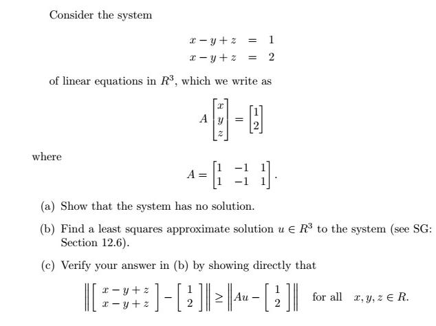

My apologies for having to post in an image, my latex skills are not good enough for the question at hand :(
a) There is no solution since the system has more unknowns than equations (the equations are equal giving 1=2 which does not make sense).
b) I get a solution of \begin{bmatrix}1 \\1 \\ 3/2 \end{bmatrix}
for u.
c) I am not sure how to prove this directly, since there are no values for x,y or z.
