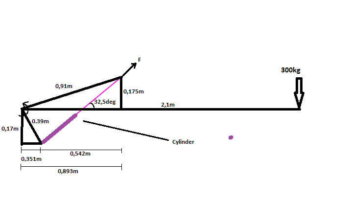

So the task is to calculate how much force a cylinder supports in a front loader when the load is held in a horisontal position. I have made a simplified diagram of the problem with the known data.
I hope that my attached image makes any sense.
Thanks in advance.
Simplified diagram of a front loader arm held horizontal, with a 300kg load at the right end, a hydraulic cylinder angled at 32.5 degrees, and labelled lengths including 0.91m, 0.175m, 2.1m, 0.39m, 0.17m, 0.351m, 0.542m and 0.893m.

Free-body diagram of a front loader arm: a horizontal beam pivots at the left, with a 300kg downward load at the far right, a cylinder angled at 32.5 degrees, and labelled lengths 0.91m, 0.175m, 2.1m, 0.39m, 0.17m, 0.351m, 0.542m and 0.893m, plus an applied force F.
Are there no movements or deformation? Does the suport structure (in black) have mass? If not, first calulate the amount of torque created by the weight around the pivot point, then, at the position where the 0.175m stick is, a upward force can be calculated, this force should create a torque strong enough to cancel out the weight's torque. The upward force is supplied by the cylinder's support (so I think from looking at your diagram) and it is the vertical component of the force created by the cylinder. Using trignometry, find out the total force the cylinder is applying. Have fun in P.F.
