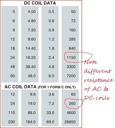

Regarding the coil, the AC and DC requirements are usually the same. So a relay designed for 24V AC should be OK for 24V DC.
Not so at all.
A DC relay coil has enough resistance to limit the current through it to whatever the designer wanted it to be.
An AC relay coil has far less resistance, instead depends on its inductive reactance to limit coil current.
When first energized it draws several times its rated current and does so until the armature plunger moves into position reducing the air gap which raises inductance, pushing coil current back down to design value. Inrush might be 10X steady state current.
AC relays also have ,magnetic shading on the pole to prevent buzzing when closed , DC poles don't need it because there are no zero crossings.

For the AC type, there is an inrush current during the operation time (for the separated condition of the armature, the impedance is low and a current greater than rated current flows; for the adhered condition of the armature, the impedance is high and the rated value of current flows), and because of this, for the case of several relays being used in parallel connection, it is necessary to give consideration to power consumption.
Apply 24 volts DC to a 24 volt AC relay coil and you'll probably let the smoke out of it in just minutes.
Here's a snip from the datasheet of that relay
http://oenindia.com/uploads/products/58_20160601032651.pdf
Calculate the power in each with 24 volts DC applied , E2/R , to convince yourself .

jim hardy said:
Not so at all.

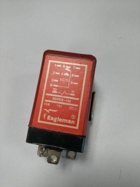

I have this relay with me. My doubt is whether can I use AC across coil and make a chattering circuit>?

By this specification what it means? I have a Eagleman relay, their website showing these details only.
the pic of the one you have shown is a 12V coil
As Rive said many posts ago .....

The 24V AC version will ~ work as the 12V DC version, but for this family this kind of operation is out of spec. I do not recommend it. Buy the right tool for the job.
so if you put anything significantly higher than 12V across it, it will failDave
