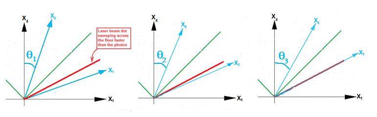

Fredrik, I think yours is far and away the most interesting. Here are a couple of space-time diagrams to illustrate your example. I've just presented a succession of cases with a blue guy running faster in each diagram. The successive increase in the angles, theta1, theta2, and theta3 emphasize the successive change in slope (increase in speed) for the blue guy's X4 axis. And of course the blue guy's X1 axis (the instantaneous 3-D world that blue "experiences") successively rotates counter-clockwise to maintain the constant speed of light (green photon worldline always bisecting angle between X4 and X1 for all frames of reference, i.e., speed of light is the same for all observers regardless of their speed).
In the third frame, the red laser spot is moving at infinite speed in the frame of the blue guy.
Are we sure about this moving laser dot thing? Nothing is actually moving faster than the speed of light; can we really justify plugging this apparent velocity into a S-T diagram or velocity transformation?

Don't worry. Nothing is really moving faster than the speed of light. That is, there is no single material particle moving. It's kind of like the old sizzors example where one has a very long pair of sizzers and closes the sizzors very rapidly. The intersection of the two blades can move faster than the speed of light. But the intersection point is not some particle or object doing the moving.
Imagine how fast you could sweep a laser spot across the surface of the moon (standing on the Earth with a laser pointer). The changing position of the spot does not mean that some particle has actually moved--it's clearly not one group of photons doing the moving across the surface, and moon dust particles are certainly not doing the moving.
But, yes, you can represent that laser spot motion in the space-time diagram--just keep track of what it represents.

As bobc2 said, no particle is moving faster than light in this scenario. The motion of a dot moving faster than light obviously has to be represented by a spacelike line in a spacetime diagram, like the red line in bobc2's diagrams. Those are exactly the diagrams I had in mind when I said that the easiest way to see this is to use a spacetime diagram. The only thing that should look suspicious is that I plugged in a value greater than 1 in the velocity addition formula. If you have derived that formula by explicitly verifying that the composition of two Lorentz transformations has a velocity given by that formula, you might not expect it to be valid when one of the velocities is greater than 1. But you can also derive it in a way that makes it obvious that only one of the velocities need to be less than 1:

Oh, I'm perfectly aware that nothing is moving faster than the speed of light (as that was my point), and I know how to do the transformations. I was just surprised that we could still plug this illusory FTL motion into the equations and get meaningful, physical results out of it.
