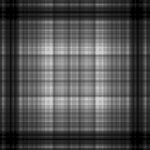

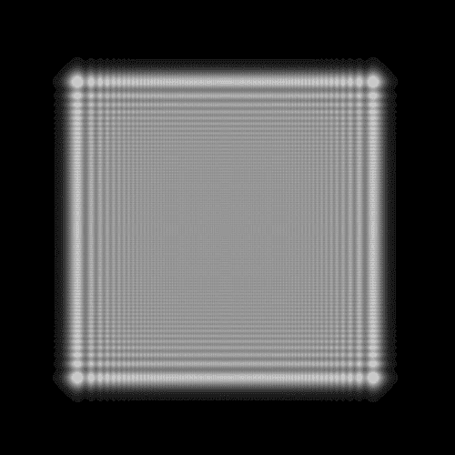

Thank you. I tried simulating this using an input plane with a white pixel at the middle, but the simulation returns a diffraction pattern similar to a square aperture, which I guess is not a PSF. Might be the PSF is the smallest resolvable point in the image?
Where did you put the input plane? If it's located at the front focal plane and the output at the back focal plane, the field at both plane is related through a simple FT assuming the lens aperture is very big.
I have put my input plane at 400 meters from the lens (a thin lens, with a focal length of 1.0 meters). The input then propagates until at the front of the lens and I multiplied it with a thickness function
##t_{l} = e^\left[-i \frac{k}{2f} \left(x^2 + y^2\right)\right]##
to know the diffraction pattern at the back of the lens, the pattern then propagates until the sensor which is approximately 1.0256 meters from the back of the lens.
Two possibilities come to mind:
1) what is the shape of your aperture? If it's rectangular or square, that would explain your result.
2) Is your object truly a point or could a 'pixel' be interpreted by the code as a square/rectangular object? That would also explain your result.

The pixel does look like a mini-square aperture, so I guess it does explain why I have square diffraction pattern. But then, how would I acquire the PSF if this is the case?

Speaking of your simulation, when you observe the diffraction pattern reminiscent of that of rect aperture, did you only look at the square amplitude of it? It makes sense that you got such result due to the pixel shape influence of the computer, but if you plot the real part (or imaginary part) of the output field I think you should observe a ripple-like pattern, which is caused by the quadratic phase at the output plane. Taking into account this phase will make your simulation closer to reality as one normally would observe a spherical wave out of a lens.

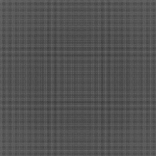

I want to simulate the PSF of my system, and use the PSF to de-convolve the blurred image acquired by the output. Here are the results of my simulation by using a single pixel as my point source:
The first image is the diffraction pattern at the back part of the lens (the diffraction pattern at the front is similar, only brighter); and the second image is at the output plane a certain distance from the back of the lens.

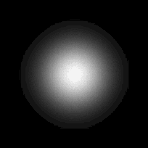

Is this what you're talking about? This image is the intensity pattern at the output plane.

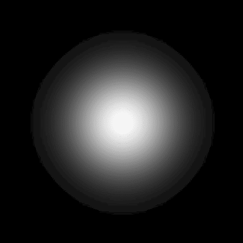

I also tried enlarging the point pixel by making 3 x 3, rather than 1 x 1. Here is the resulting image at the output plane:
Is this the PSF? :confused:

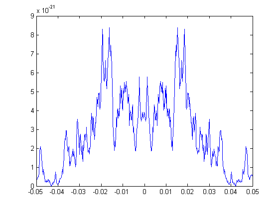

Also, I found this thread: https://www.mathworks.com/matlabcentral/newsreader/view_thread/307631. There is a suggestion here of using the 'deconvreg' of MatLab to acquire the PSF.

Typically, the PSF is larger than 1 pixel- that is, the system should be sensor limited, not lens limited. Here's an example of a 'measured' PSF (scaled x10 so you can see it better)
Computationally, this can be simulated by applying a blur filter (gaussian convolution, for example) to your single-pixel PSF. Try a 3x3 blur or 5x5 blur, and you may want to start with a 2x2 or 3x3 unblurred PSF instead of a single pixel.

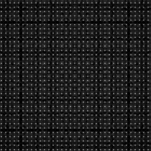

Then, are all these points possible candidates for the PSF? They're somehow similar to your PSF. Although this image is produced when the input plane and output plane are 1.0 meter at the front and back of the lens, respectively (with a thin lens having a focal length of 1.0 meter).
I can't make out what your image is- an array of points? If I look closer, it seems that each bright point is surrounded by an airy-like pattern, with interference between neighboring patterns... yes?
I guess I should mention the PSF image I posted is actually |PSF|, since it's intensity and not field.
Ah- now I can zoom in. Try adjusting the object and image distances so that your image is a true image of the object and see what it looks like.
Yes, it is an array of points with interference-like patterns in between points. The intensity of the image is ##I = |U|^2##, where ##U## is the diffraction pattern of the electric field (I don't know if this is correct. The object propagates by Fresnel Diffraction with the Angular Spectrum Method, and Fourier Transform is necessary).
