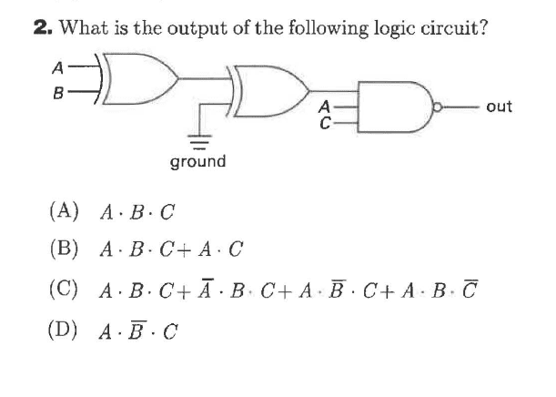

What is the output for the following logic circuit?
DeMorgan's Law
Logical Operations involving Logic Gates
I obtained the following result:
([(A xor B) xor 0]* AC)'
([(A'B + AB') xor (0)]*AC)'
[([A'B + AB']*(0)' + 0)*AC)]'
[(A'B + AB')*(1)*(AC)]'
[A'ABC + AB'AC]'
[AB'C]'
A'+B+C'

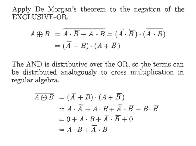

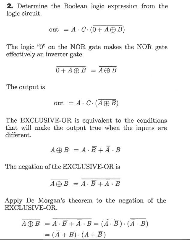

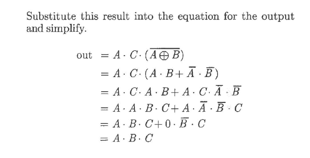

the solution to this problem is getting a different answer, I don't know why this solution isn't inverting the output AB'C

I agree with your answer. I think the simplest way to see that the given answer is wrong is to consider how C appears in it. The only appearance of C is as an input to the final NAND. It seems that +C' must be in the correct answer.
I was looking back and forth and at the given answer and wondering if the circuit and the explanation actually even go together. The explanation says the second gate is a NOR and the last gate is an AND but that's not what's drawn.

Which yields A'+B+C'
Code:
A B C | O
0 0 0 | 1
0 0 1 | 1
0 1 0 | 1
0 1 1 | 1
1 0 0 | 1
1 0 1 | 0
1 1 0 | 1
1 1 1 | 1
