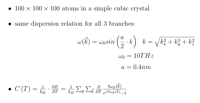

I'm trying to plot the heat capacity as a function of the temperature from some small temperature to Debye's using numerical summation over the energy (shown in the photo below).
However, I'm struggling to determine the boundary of k (actually, of all three since there are 3 sums).

In a periodic crystal the largest k of lattice vibrations is pi/a. (I am not sure I understand the question.)
Yes, so I believe. I summed over the FBZ (-pi/a to pi/a) for each of k's products.

It is sufficient to sum over one irreducible wedge of the Brillouin zone, that saves some computing time.

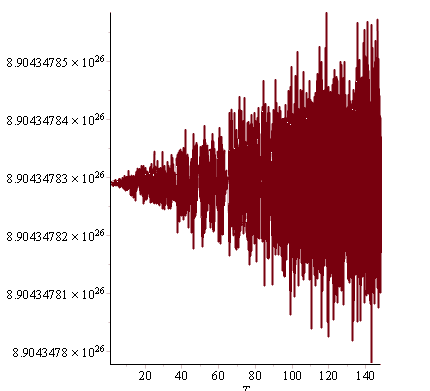

Hi,
I tried plotting it first in 1D (hence sin(k*a/2) where k has only one product) and i receive the expected graph of C(T) vs T.
However, when I plot it in 2D and 3D it becomes this deadly noise-like signal (example shown below for what I got in 3D).
Any idea where I could be mistaken? I literally just plugged the expression in Maple..
So that is basically a constant large value. With numerical noise that increases linearly with temperature.
And I assume that you know that it should start out as T^3, approaching the Dulong-Petit value asymptotically for height T.
