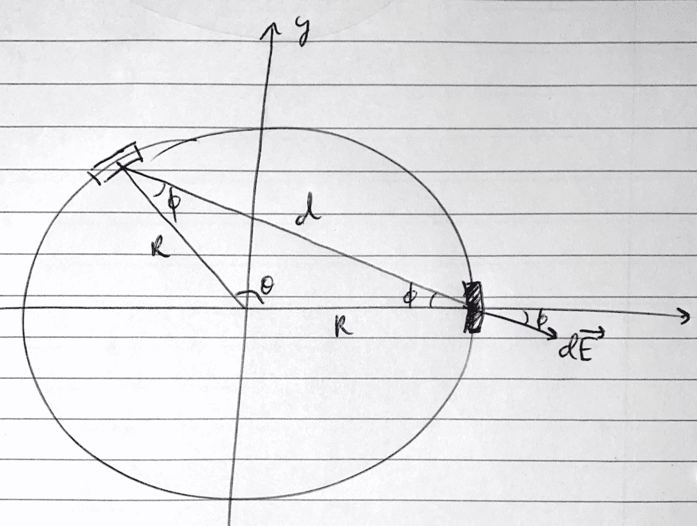

etotheipi said:
Homework Statement: The ring I'll assume to have negligible thickness, and linear charge density ##\lambda##, as well as a radius ##R##.
Relevant Equations: N/A
I tried considering a little piece of the ring (shaded black below) subtending angle ##d\theta##, and attempted to find the electric field in the vicinity of that piece by a summation of contributions from the rest of the ring:
$$dE_x = \frac{dq}{4\pi \epsilon_0 d^2} \cos{\phi} = \frac{\lambda R d\theta}{4\pi \epsilon_0 \cdot 2R^2(1-\cos{\theta})}\cos{\phi}$$ $$E_x = \int_0^{2\pi} \frac{\lambda \sin{\frac{\theta}{2}}}{8\pi \epsilon_0 R(1-\cos{\theta})} d\theta = \frac{\lambda}{8\pi \epsilon_0 R} \int_0^{2\pi} \frac{\sin{\frac{\theta}{2}}}{1-\cos{\theta}} d\theta $$ Problem is, that thing diverges because the denominator goes to zero at the boundaries (the indefinite is easy enough to solve by changing ##1-\cos{\theta} = 2\sin^2{\frac{\theta}{2}}##). If we call $$I = \int_{0}^{2\pi} \frac{\sin{\frac{\theta}{2}}}{1-\cos{\theta}} d\theta$$ then the electrostatic force on the piece in terms of this is $$F_e = (\lambda R d\theta) \frac{\lambda I}{8\pi \epsilon_0 R} = 2T\sin{\frac{d\theta}{2}} \approx T d\theta$$ and the tension would be, under the usual equilibrium constraint, $$T = \frac{\lambda^2 I}{8\pi \epsilon_0} = \frac{q^2 I}{32 \pi^3 R^2 \epsilon_0}$$but that doesn't make much sense if ##I## is infinite. I wondered if anyone could help out? Perhaps it is the case that the electric field diverges at the ring, but in that case, how could I modify my calculations to get a sensible answer? Because I am fairly sure that in reality the tension will not be infinite 😁. Thanks!

You are getting the expected divergent behavior for the tension for the idealized circular ring with zero thickness. The tension is infinite in this case. See some of the earlier discussion in this thread. Post #39 has some numerical calculations.
