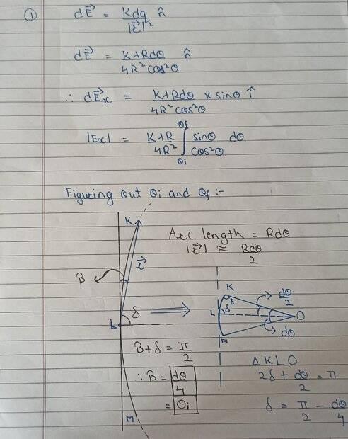

What is the tension in a charged ring?
103 replies · 16K views
Vanadium 50 said:
Not exactly - that would change Coulomb's Law as well. I think that's what etotheipi's paper is about. I am not changing Coulomb's Law. However, I am working strictly in a plane. Because that's what the problem said to do. I would not call it an infinite cylinder because I don't know what the role of λ would be in that geometry.
Let me explain what I both understand and don't understand about the field line approach you propose (I'll go back to a 3D universe :wink:).
The number of field lines through a surface that encloses the ring is a measure of the flux out of the surface, and is proportional to the enclosed charge. So if we make the ring smaller but maintain its charge, the number of field lines through any surface enclosing the ring will not change. This is okay 😁.
But what I am struggling to understand is why that implies the field just outside of the ring in the radial direction is ##\frac{Q}{4\pi \epsilon_0 r^2}##, at a distance ##r## from the centre. That appears to only be the case if we have spherical symmetry. You did mention that you were only considering field lines in the plane, but I'm not sure this is valid since we are still applying the 3D theorem of Gauss.
Indeed I tried finding an explicit formula without heuristics and ended up with some horrible integrals that I could not solve, which seemed to imply to me that the radial field outside of the ring did not take such a nice form.
I wondered if I had misinterpreted anything you said?

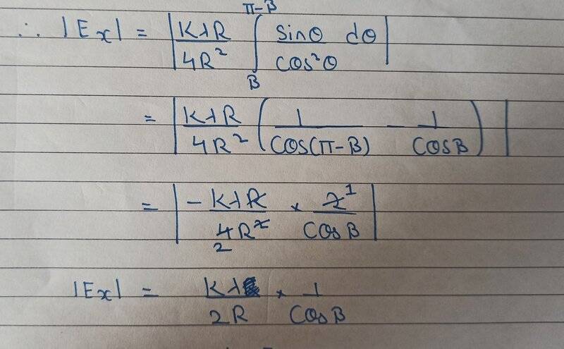

Alright, thanks for your help. I still do not think that the field outside the ring is ##\frac{q}{4\pi \epsilon_0 r^2}##, although I would agree that the field reduces to this in the limit ##r \gg R##. I don't think either of the shell theorems apply to rings in a 3D universe.
So perhaps we will agree to disagree :wink:. You did manage to get an answer, though, but I think I am happier not having an answer than accepting one that I don't understand. In any case, an interesting discussion!

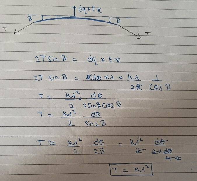

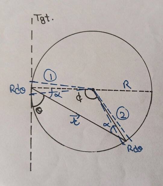

PeroK said:
What if you consider a small element on the right, and calculate the tension on that and take the limit as the size of the element goes to zero?
I don't know if that would work out. It's just an idea.
etotheipi said:
Actually that's a pretty good idea, have some (no longer infinitesimal) control region on the right that subtends an angle ##\alpha## or something, and try to come up for an expression for the electrostatic force on that.
It's slightly more complicated maths-wise and I'm not so sure how best to do it yet, but I think that would give something useful! Let me think about it for a while 😁
Thanks!
This a good approach. For an infinitesimal segment subtending angle ##\alpha##, the force on the segment is due to the net electric field of all of the charge of the ring excluding the charge in the segment itself. (The field due to the segment does not exert a net force on the segment itself.) So you just need to modify the limits of the integral ##I## in the OP. Everything else in that post looks good. When I carry out this procedure, I get an expression for ##T## that agrees with ##T = F/2## in post #39 in the limit of infinitesimally small ##\alpha##. In particular, you get the logarithmic divergence as ##\alpha## approaches zero.
