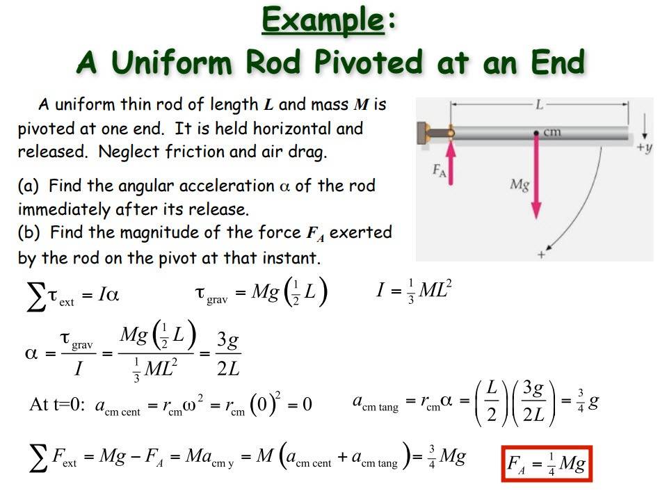

I have seen an example of a horizontal beam on a hinge. Beam of length L acted on my gravity MG at center, where the hinge supplies 1/4MG force to the door. Therefore there is a net torque, causing angular acceleration and a net force, causing translation about the center of mass.
Maybe it is because many examples focus only on the torque, but i read examples where they only look at the torque on a interior house door say a person pushes it. But if i am not mistaken when we push a door, similar to the beam, there is both torque and force which is why it moves? Without some force, it would have no torque, but it need a force to move its center of mass as well.
Maybe i have taken the force at the hinge point for granted, as with wheels and gears, it is equal to the applied force, so it creates no torque and it can safely be ignored.
Attached is an example of what i reading and applying to the door.

There is both a net force and net torque that get it moving correct?
So from what i understand, since this is not a wheel or gear where the system is balance by an equal force from an axle so the CofMass doesn't move, there has to be BOTH net force and net torque to make a door swing correct?

So because there is both change in angular moment and the c of mass moves in the door hinged(not revolving around a center), there is both net force and torque correct? I feel like i didnt think about it before which is why it is odd. So please let me know
Yes. That is the correct conclusion that you should draw.

A hinge is a device which is designed to provide any arbitrary force but zero torque (about the hinge). You only care about the torque because the hinge force can be whatever it needs to be to satisfy the motion determined by the torque.

A hinge is a device which is designed to provide any arbitrary force but zero torque. You only care about the torque because the hinge force can be whatever it needs to be to satisfy the motion determined by the torque.
This makes a lot of sense. The hinge helps provide centripetal force to maintain rotation and create the tangential forces on the center of mass so it moves both rotationally and translationally equally.
Makes a lot of sense then why torque is of the main concern

For an ordinary swinging door, the kind that is hinged at one side: Force causes the center of mass of the door to move, torque causes the door to rotate on its hinges.
For a revolving door: the center of mass doesn’t moveso there is no net force on the door. There is a torque, and that’s what causes it to revolve.
