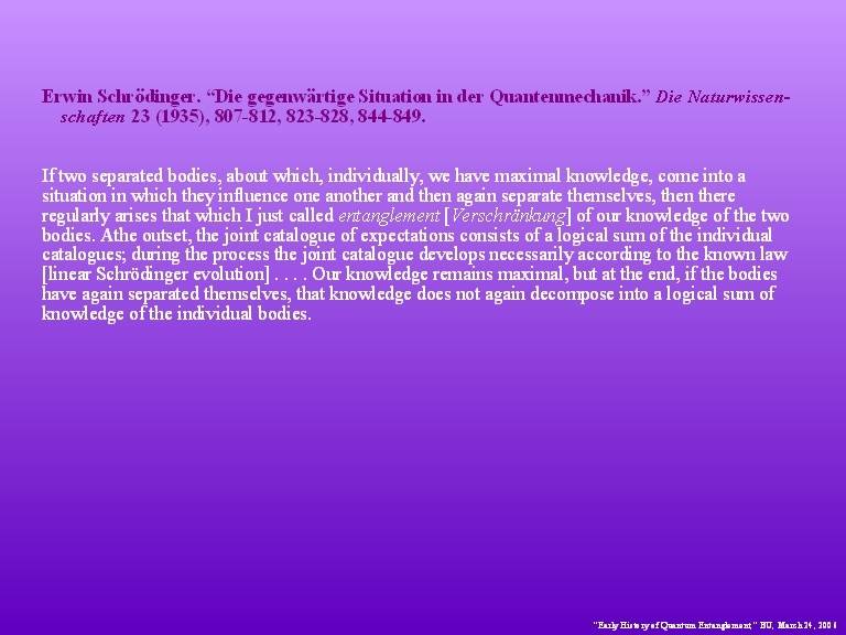

The term was coined by Schroedinger. Both the person who coined the term and the context of its first use give clues to its manner of deduction:
From https://www3.nd.edu/~dhoward1/Early History of Entanglement/sld003.html:
It would appear that the entire body of then-known QM knowledge was being considered in an overall examination of particle interactions. At the time the term "entanglement" was coined, Schroedinger was highlighting this type of interaction as a particular issue - without predicting specific characteristics of the entanglement.
