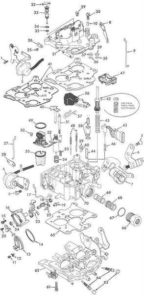

When I start my car (a 1972 Lincoln Mark IV) a plume of thick, foul smelling black smoke comes out the exhaust. About ten seconds later my car stalls, I start it back up for it to repeat this process about 3-4 times until I can finally get it going. It also stalls whenever I change gears. Why is there so much black smoke billowing out the exhaust? Why does it keep stalling a few seconds after you start it?

Black smoke means air-fuel mixture is too rich.
I would go with Ranger Mike's advice: start with checking air flow restriction. Remove the air filter and try running it with the carb taking air directly. If it works than you have a restriction somewhere in the air duct (dirty filter?).
But, most likely, the car was unused for a long period of time (6+ months) and the http://www.sterndrives.com/old_fuel.html" . Probably the needle (#58 on the drawing, connected to the float #56) that is full of varnish (or other debris) and stay open constantly. Carburetor probably needs a rebuild (clean-up) as xxChrisxx said.

Sounds like your carburetor is in need of cleaning and a new set of gaskets. If you have extreme amounts of hydrocarbons, you have either a what has been mentioned already (air flow restriction) or a bad gasket allowing fuel to enter the induction tract in the wrong manner. You should be able to smell the gasoline on the plug and see fouling on the electrodes if the rich of stoich is at the extreme point.

It's flooding (too much fuel).
FishmanGeertz said:
What could be causing this?
The choke isn't set right or isn't opening properly.
Next time you start the car, have the air cleaner lid off and check the choke plate to see if it opens after starting. It should have a vacuum operated choke pull-off (#2 or #4 in the above diagram) that partially opens the choke plate right after starting. Ford carbs had a tendency for failed diaphragms in these pull-offs.
If the choke doesn't open at least part way, grab a screwdriver and prop the choke open and restart the engine. It should run reasonably well on its own now and without belching black smoke.
After the engine is warm (5-10 minutes), the choke plate should be fully open on its own. If not, the choke thermostat isn't working. For now you can adjust the choke mechanism so that it is fully open. Loosen the screws holding #13 and rotate while holding the throttle partly open (engine off) until the choke plate is vertical.
