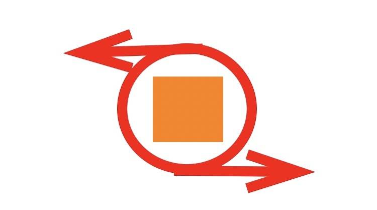

So would it be correct to say whenever you have current through a wire, you can use the RHR to find the direction of the magnetic field around any given point on that wire? A wire being any circular conductor in this case. I suspect that we couldn’t apply the RHR to a wire with a non-symmetrical shape like the in the attached image (assuming the current is flowing out of the image).
If the wire is twisted and in some weird geometry, then you can't simply use the RHR, because this is no longer a straight wire.
Zz.
Zz.
