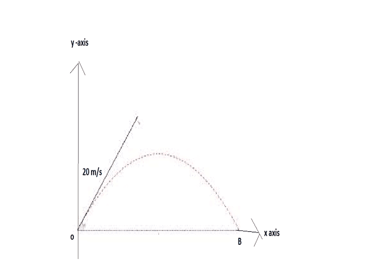

There is a projectile which is launched at point "o" and land at "B".It was thrown with 20m/s with angle of 53 degree.Take g=10 m/s^2 sin theta=0.8 and cos theta=0.6
Find the time at which magnitude of x component of velocity of projectile is twice the magnitude of y component of velocity.
Diagram of a projectile launched from origin o at 20 m/s, showing a dotted parabolic trajectory rising and landing at point B on the x axis, with labelled y axis and x axis.
v sub x =u sub x +a sub x t
u sub x=initial velocity in x-direction i.e u cos theta =16 m/s
v sub x =velocity in x direction at time t.
v sub y =velocity in y direction at time t
v sub y =u sin theta +(- 10 t)
v sub x=2 (u sin theta +(- 10 t)
but v sub x=u cos theta (as acceleration in x i.e horizontal direction is zero.
so,u cos theta =2 (u sin theta - 10 t)
putting given values give
t=1 sec.
But in book two answer are given
t=1 sec
and t=2.2 sec.
How I can get t=2.2 s ?
Actually there would be two cases when horizontal velocity would be 2 times of vertical velocity as shown in your attempt.
Consider the case when projectile reaches highest point, calculate the time for it.
Then see the additional time where once again the horizontal vel. would be equal to 2 times the ver. Vel.

Find out how much time it takes for the ball to reach the top of the parabola and start falling back to earth.
In your equation:
vx = 2[u sin (θ) ± 10t],
you picked the negative sign and worked out t. What if you then picked the positive sign and solved this equation? What value of t would you get then?

The first comment still applies. After the ball reaches its maximum height and starts falling again, there will be another point where the horizontal velocity is twice the verical velocity. :wink:
I got your point.As there is symmetry ,there will be another point where the horizontal velocity is twice the vertical velocity.Thanks .:smile:
