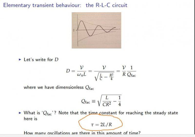

Where is the RLC circuit time constant"2L/R" coming from?
10 replies · 15K views
garylau
70
Sorry
i want to ask a question about RLC circuit~
i don't understand where is this "2L/R"coming from
and also i don't know what is the function of this" time constant"(it is meaningless in physical sens?e)
in the note it states"that the time constant for reaching the steady state here..."
how did he knows this is the time constant that lead to the steady state?
thank you​

This is a resonant circuit consisting of C and L together with some losses represented by R.
The oscillations gradually diminish, in an exponential manner, similar to the discharge of a capacitor. Eventually the amplitude falls almost to zero. The time constant is the period of time after which the amplitude has fallen to 1/e.

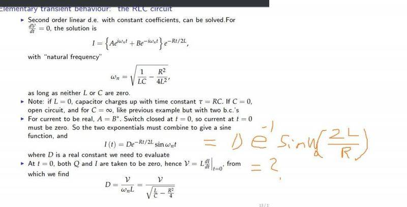

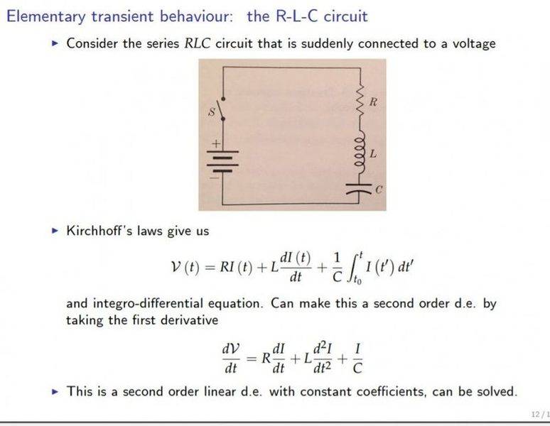

Oh Sorry
Also for your circuit arrangement, the result of my calculation example still applies.
The reason is as follows: The current through the whole circuit (your task) has the the same form (in the time domain) as the voltage across the capacitor (my example). That means, the damping properties are identical - and hence the time constant.
Oh i See
but when i try to put "2L/R" into the equation
i didn't see anything special?
there is no well-defined "amplitude" in this case?
because there are two terms
De^(Rt/2L) * Sin(omega*t)
if i try to put t=2L/R then it will become (63.4%)*D*sin(omega* 2L/R)
it seems (63.4%)* D = Amplitude of that D which the power is dissipated 50%?
