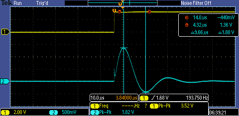

The image attached is of an underdamped RLC step response. I know that I can find the damped frequency of the response by first finding the period of the wave, and manipulating the period such that I can do 2*pi*f.
If I'm looking at this waveform and the only info I know about it is this period and damping frequency, how could I figure the time constant?

RLC circuits are 2nd order. We don't usually speak of a time constant, for oscillatory responses we speak of their damping factor (or, instead, the Q-factor).
The time constant of a first or second order LTI system characterizes its rate of exponential decay. The impulse response of an underdamped second order system is a sinusoid of exponentially decaying amplitude, so the term is still well defined.
Four time constants would put the signal within 2 percent of its steady state value so you could just eyeball it. Alternatively, the time constant, tau, of an underdamped second order system is given analytically as:
tau = 1/(zeta*omega_n)
where zeta is the system damping factor and omega_n is its natural frequency of oscillation.
Edit: Correction, 2 percent - not 5.
