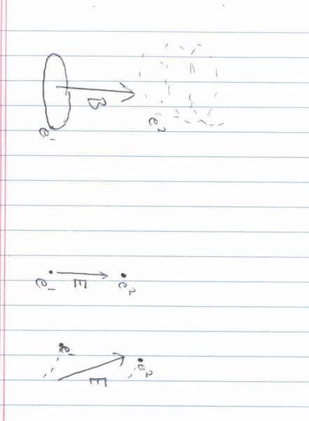

So if the E and B fields are coupled, and the B field can only interact with a charge, then couldn't the B field just be written as components of the E field and eliminated altogether.
For example you could have a loop current and say there is a B field perpendicular and any electron in the field will precess.
Or you could say there is a loop current and any electron perpendicular to the current will precess because of the accelerating E field emitted by the charge as it loops.
I attached a doodle of what I mean. A movement of a charge can be explained without the B field, only the E field.
If e1 starts to rotate, e2 starts to precess because of the new component in the E field.
Your argument seems flawed to me. Let's say that we place a charge at rest in the same area you draw the precessing charge in your picture. Then, by your argument of an "accelerating E-field," the charge must move. What must happen though is that the charge does not move since v X B = 0.
How would it not move? There is an E field from e1 that would give it an acceleration in the upward direction (since electrons repel) and also since there is a change in the E field the electron would begin to follow the field.
My apologies; I imagined a very long and wide solenoid as replacing your looping charge without actually stating it.
The reason I did this was to show an example where your idea wouldn't work. Also note that this is the type of setup you'd need to make a uniform magnetic field.
A problem with the looping electron picture is that a single moving charge does not constitute a "steady current." As such, it makes the analysis much more cumbersome.

Appreciate that the authors of #2 and #23 will think this has already been answered, but came across this quote from another thread:
https://www.physicsforums.com/showthread.php?t=286388
turin said:
spidey, I think the concept you're missing is the distinction between electrostatics and electrodynamics. This business regarding the distinction between the classical and quantum description is irrelevant. In electrostatics, i.e. Coulomb's Law and such, there cannot be an electric field without a charge to source it. However, this is no longer true in electrodynamics. In fact, mathematically speaking, there are such solutions to Maxwell's equations that don't require a source anywhere in the universe. Such solutions are the so-called free-field solutions, aka plane wave solutions. It is just a simple fact of electrodynamics that a changing magnetic field can induce an electric field, no charges necessary. Why the changing magnetic field is there in the first place is a chicken-egg issue.
If charge is a fundamental unit of physics, then I would have thought the E-field is also a fairly fundamental by-product. In the context of electrostatics, where ‘static’ is taken to infer absolutely no motion of the charge, not just slow, then presumably only the E-field exists, at least, between it and some other charge?
OK, I accept that this static frame is only relative, but it does seem to suggest that the B-field is a secondary by-product of a moving charge? Of course, for all practical purposes, this absolute distinction may not be relevant and unifying the 2 fields makes much more sense in terms of electrodynamics.
As a slight aside, I know that mixing the description of an EM wave and a photon is a bit of a no-no, as they belong in different models, but if a photon only describes the energy [E=hf] being transferred, how are any changes in the E-field propagated between 2 charges subject to a change in distance due to a constant velocity drift, i.e. no acceleration? Is the change in the E-field propagated along the field lines? If so, is the propagation velocity 'c'? Thanks
