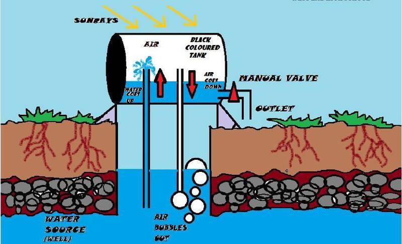

Thanks for all your help..I'm trying to build a kind of tank for my pumping device that can be made using a low cost metal.The metal should also have a quick absorbing and radiating property of heat. I've thought about painting the tank black from in as well as out to increase its absorbing and radiating property. I've taken Aluminium as an option , but thinking of anything much better and easily available at low cost. So that the surface of my tank absorbs the sun's heat and radiates it to the air inside so that the air gets heated and it expands.

I need this metal in large quantity to mould a cylindrical tank for my project.
This the the look of my project..and I need a metal to make that tank to absorb heat from sun and radiate it to the air in the tank so that the air expands down the two pipes
That does not look like it will work... Where is your pump?
I am only guessing about this but maybe he plans to use the temperature differences between day and night, to pump the water.
The expansion during the day would force air out and the contraction during the night would suck water up.
In that case one pipe would be suffiecient so i am not quite sure why there is a second one and if i am perfectly honest it would be a very inefficient idea.
To get a extremely rough estimate how much water you can pump per day(ignoring the height you have to pump it up which will probably ruin everything)
you can use a form of the ideal gas law.
##\frac{PV}{T}=constant## and from that follows that you could pump up ##(1-\frac{T_low}{T_high})## of the volume of the container per temperature change(day).
And that under the assumption that you don't have to pump it up.
If the water was 3 meters down that type of pump would never even get a milliliter of water up.
