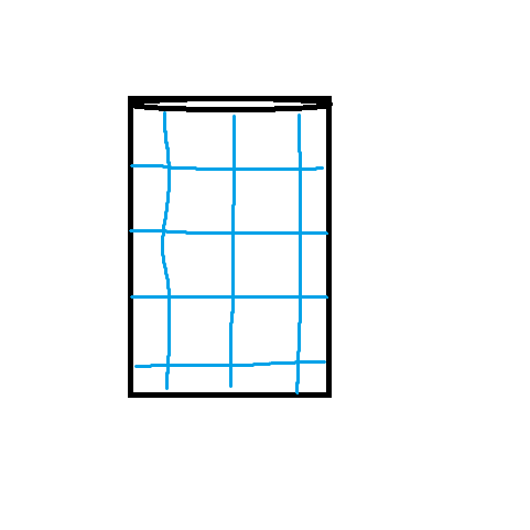

Given a cement wall, if I were to put a series of metal pins embedded within, or on the surface, could I transfer the heat that would have been absorbed by the wall to travel along the metal instead?
I had an idea thinking about heat transfer and how placing water over a hot surface will transfer the heat to the water. It got me thinking, in a case where water could not be an option for a medium could I use metal, which would still have a higher heat transfer to absorb more of the heat, which would "travel" along a path to somewhere else?

Can you post a sketch of what you have in mind? I'm having trouble visualizing what you are asking about. Just click the "Attach files" link below the Edit window to upload a PDF or JPEG image of your sketch. Thank you.
Remember that there has to be a temperature difference between the ends of the pins to drive the heat from one end to the other.

This would be how it would be structured, more or less. With the blue being the more conductive material. I would want the heat to "move" and centralize along this grid. Preventing heat from reaching the other side of the wall. Instead all being stored in the blue grid

ah excellent, I did not account for that, I will now.
Arjan82 said:
What you are referring to is called a cold bridge (or thermal bridge). But do note that water has a very high heat capacity, which means that it can absorb a lot of heat without increasing temperature too much. But steel much less so. So you can use it much better to transfer heat more quickly from one place to another, rather than absorb heat.
sweet, its got a name. I can't use water because then it would require a new active system to keep the wall cool and then there's mechanical parts. Where the grid (doesn't need to be steel) just needs to be installed and left alone. Thank you.

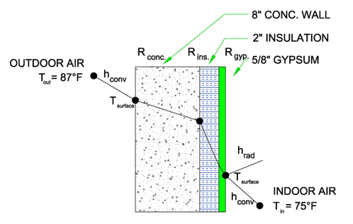

At any point of the wall, where metal and cement are in contact, the temperature will be the same.
It is only when metal is leaving the hot wall and going inside a cooler mass, that some heat flow can happen, part of which will be transferred to the surrounding air and insulation of the energy-accumulator mass.
The substantial heat flow happens from the exterior to the interior surfaces of the wall.
Sun radiation is reaching the exterior surface (point of higher temperature) and progressively heating the cross section of the cement wall to lower and lower values of temperature.
The temperature reached by the interior surface is what determines how much of that radiating energy is transferred to the shaded indoor air and residents.
If located midway, your metal grid will capture only a fraction of that flowing energy (see how little blue surface your sketch shows, compared to the cement surface); and only a percentage of that can be finally transferred to the device that could use it.

This is fantastic. Thank you for your model. So, say if the metal grid was in contact with a body of water, there would be heat transfer? If this is true, I know that metal will transfer that heat slowly, is there another kind of material I could use to transfer heat?
My original idea of the thermal batteries that would store solar radiation before it could travel through the cement, is it feasible?

Again, heat transfer into the metal grid (and out of it) is only possible when a temperature differencial exists between it and the surrounding substance.
The greater that differential, the more thermal energy would be transferred per unit of time.

If there are metal pins embedded within the concrete wall from the exterior extending inwards, the 'insulation' properties of the concrete itself is being circumvented.
