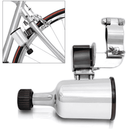

By the way, doing it as a DC generator instead of an alternator is simpler. Old fashioned bicycle generators used simpler DC methods.
Whoops, @Baluncore informed me that I was wrong. That bicycle generator is not DC, it is an AC dynamo.
