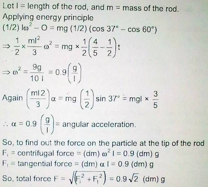

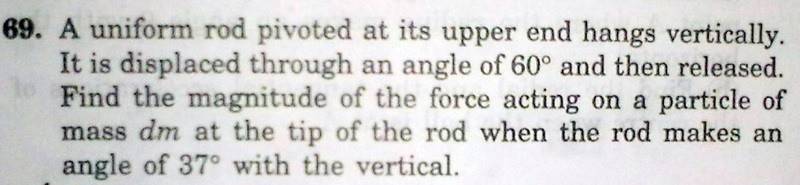

Hi all :biggrin:
This was a solution to my problem i found on internet ...
I found w2 correctly like in solution ... but then when i thought that that net force will be force due to rod (F) - mg cos37 ... along rod ...
and mg sin37 perpendicular to rod ...
F - mg cos37 = (dm)w2L = .9 (dm) g
mgsin37 = (dm) g (3/5)
But I'm wrong ! :cry:
WHY? :confused:
And please someone explain me what is written in solution after finding w2 ... i can't understand it :-pEDIT:I got what they have written in answer ... they used τ = αI to find α
they used to find (dm) (dv/dt) = (lα)(dm) ie tangential force ... now i need to know .. why i am wrong in my way ? ... :confused:

your mg sin37° and mgcos37° are only the weight
you've ignored the tension in the rod …
this method finds the total ("net") force, which is the LHS of F = ma, by just getting the RHS :wink:
The equation after finding w2 is:
ml2/3 (alpha) = mgl/2 sin37.
It is just an equation connecting torque, moment of inertia and angular acceleration
how have i ignored tension?
I found F(tension) - mgcos37 ... i.e. along rod
and mg sin37 ... i.e. perpendicular to rod!
That includes tension, Rioght ?
ah, no
the tension force is only mgcos37° on a flat slope …
that's because the acceleration perpendicular to a flat slope is zero, and so you can take components perpendicular to the slope: T = mgcos37° …
in this case, the acceleration perpendicular to the slope is not zero, so that doesn't work! :smile:

I guess you are not understanding what i have done
i haven't taken mgcos37 = T
i have used T - mgcos37 = mv2/r = mw2r
And as i have taken X,Y axis as perpendicular to rod, along rod respectively so the only force in X axis is mg sin37 (and no tension of rod)
so shouldn't that be right?
but the question asks for the total force …
where does that appear in your solution? :confused:
… the only force in X axis is mg sin37 (and no tension of rod)
this is a rigid rod, not a rope or chain …
it does have "tension" perpendicular to its length
