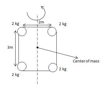

Why are there no negative signs in this solution?

Calculating moment of inertia for 4 bodies by parallel axis theorem.
##I_{CM} = 2kg (1m)^{2} + 2kg (1m)^{2} + 2kg (1m)^{2} + 2kg (1m)^{2} = 8kgm^{2}##
245254
##\sum {I} = Md^{2}##
##I_{P} = I_{CM} + Md^{2}## (##M## is total mass of all 4 bodies)
##I_{P} = 8 + 8(1) = 16kgm^{2}##
As I understand the drawing, you have four masses arranged in a rectangle. You compute the moment of inertia about a vertical center-of-mass axis that is embedded in the plane of the drawing. The goal is to compute the moment of inertia about a parallel axis at a distance "d" away from the center-of-mass axis.
You apply the parallel axis theorem and add the moment of inertia of the assembly about its center of mass axis to the moment of inertia that a point mass at that center would have about the chosen axis.
Apparently d = 1 meter.
The thread title asks why there are no negative signs in the calculation. Why would you expect negative signs in the calculation?
If two moments are positive side and other two will be obviously negative because axis is located at the center.
I am having trouble following this reasoning.
Moment of inertia is the sum of ##mr^2##. The r term is squared. Its sign is irrelevant.
