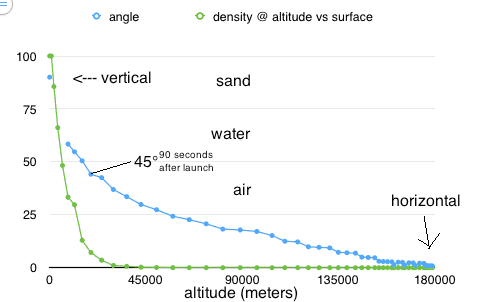

Interesting question: "Why do rockets turn horizontally so soon after launch?", from a 12 year old.
Having never watched a rocket launch in real life, I digitized the data from the Falcon Heavy launch from 2 months ago, at 10 second intervals.
Line graph of rocket trajectory angle (blue) and relative air density at altitude versus surface (green) against altitude in meters from 0 to 180000, with the angle falling from near 90 degrees toward horizontal as altitude rises.
My guess as to why rocket scientists do it this way is because they want to travel the least distance through the sand.
"Sand, water, and air" being things you might relate to your 12 yo as being somewhat similar to air density.
  • Line graph of rocket trajectory angle (blue) and relative air density at altitude versus surface (green) against altitude in meters from 0 to 180000, with the angle falling from near 90 degrees toward horizontal as altitude rises.

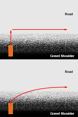

In a similar vein, I guess we have all watched games of professional tennis on TV and the path of the served ball on the serve is always shown from high over the server's shoulder. That view of the serve is for visual impact and does it tell us about the subtleties of the trajectory?
You're right that angle of view can make such observations difficult. However, as my 12 year old pointed out, if you watch and LISTEN to some of the youtube videos of shuttle launches, the shuttles altitude and range downfield is often announced at regular intervals. I don't recall the exact numbers, but it is very clear from listening to the numbers, that the range downfield is growing MUCH quicker than the altitude. This is a much better data for us to use. My son also noted that when Max Q is announced, the shuttle is way beyond 45 degrees (closer to horizontal then vertical). So the observation that the shuttle is going "partially sideways" way before it's out of the relevant atmosphere is confirmed by that.
Do you now understand why? If my simple explanation in post #11 was not clear, here is the extended version:
