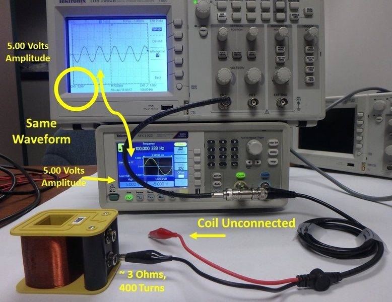

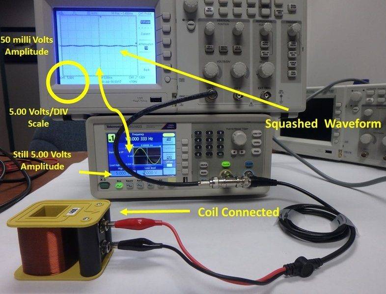

Greetings,
In the first picture below, I create a 5 volts sine amplitude signal with a frequency of about 100 Hertz. The 3 Ohm, 400 turn coil (that will eventually be part of a transformer) is not initially connected. The output waveform from my function generator completely matches my input waveform to Channel of my scope. No problem there. However, if you look at my next picture, when I try to apply my waveform across my coil, it completely squashes my signal! Is this supposed to happen? Why does this happen? My signal goes from 5 volt amplitude to about 50 millivolts (easier to see in person but you can see in the photo this is about so--I left the vols/div knob at 5 volts to compare). It seems to me that my waveform should still be 5 volt amplitude. The frequency remained unchanged whether I connected or disconnected the coil.
What is the output impedance of the generator? What is the impedance of the coil at 100Hz? Have you tried any other frequencies?

The function generator is on its "High Z" setting. What I could find from this model (Tektonix AFG 1022) is that "High Z" means some output impedance above 10,000 Ohm (10kOhm) but I couldn't find the exact value. Is the "High Z" output impedance something standardized between off-the-shelf generators or does each function generator have its own "High Z" value? In regards to other frequencies, the coil squashed the waveform in the range up to 10 kiloHertz or so. I will double-check that tomorrow, but I do remember trying other frequencies and getting the same squashed signal. Could the o-scope be reacting to the coil? I hadn't thought of that until now. If the O-scope is somehow the culprit, what should I look for about it that could cause this behavior?
If there is conductive material near the coil, such as in the table top, then the materialt will act like a shorted turn. To test for local metal, turn the coil on it's side and see if it changes the response.
The coil is an inductor with low series resistance. What is the inductance, L ?
The reactance of the coil will be XL = 2 * Pi * L.
You are driving that reactance through a Hi-Z series output impedance, so expect a potential divider effect.
Can you set the generator to a 50 ohm series output impedance?
Can you set the oscilloscope to a 50 ohm parallel input impedance?
Do you under stand what thet means?

Albertgauss said:
The 400 turn coil has an impedance of, at 100 Hertz, 13 Ohms.
How much current does 13 ohms of load demand at 5 V p-p?
Can this function generator deliver that much current?
If no, what does this particular generator do when overloaded?

If you connect only an oscilloscope, no coil, to the function generator when it is set to "high Z" (100,000 ohms) mode and 5V output
and
the input impedance of the the oscilloscope is 10,000,000 ohms, say,
then
the signal at the oscilloscope will be 10,000,000/10,100,000*5V i.e. about 5V
As you can see, it is the low impedance of the coil that attenuates the signal so severely.

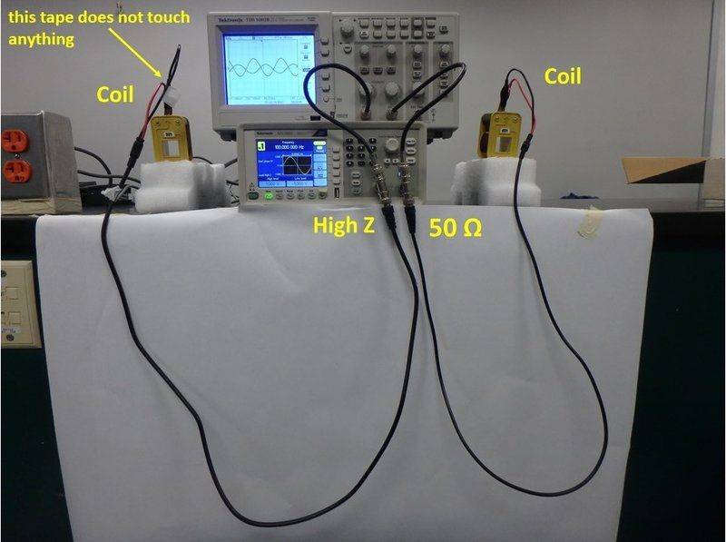

The first picture below, setup.jpg, shows my circuit. The waveforms coming out of the function generator are identical in freq and voltage for each jpeg on this reply. The output voltage from both function generator output channels are always 1 volt amplitude (I changed from 5 volts to 1 volt to make study easier). The coils are the same also, each with an inductance of 0.0212 Henry. The Channel 1 function generator is on the “High Z” impedance output and function generator Channel 2 is on the 50-Ohm Impedance output---this is what "High Z" and "50 Ohm" mean where marked on all he jpegs I attached to this reply.
In the setup, hopefully there is no interference with any other flux except what the coils themselves produce. The coils are elevated on styrofoam. I did try the coils to be horizontal and vertical, with no change in signal.

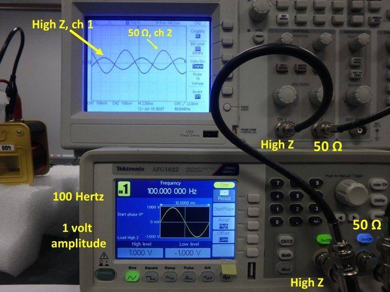

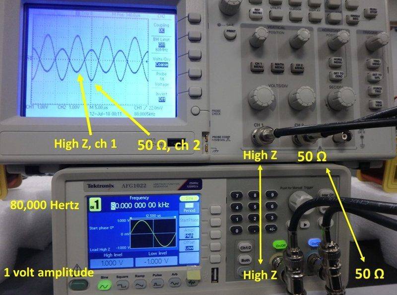

In the jpeg, 100Hz.jpg below, both channels are driven at 100 Hertz so the impedance of each coils is 13.2 Ohms. The 50-Ohm FC output impedance should give a voltage of 13/(13+50) = 0.21 volts on the oscope display, but you can see from "50 Ohm, ch2" on the jpeg below that this calculation disagrees with the 0.12 volts that is actually there. The voltages divisions on both oscope channels are 100 millivolts per division. The High Z output function generator impedance gave on the scope a voltage of 80 millivolt, (High Z, ch 1) but if you calculate what the voltage should be on the oscope screen assuming High Z = 10,000 Ohms, you get 13/(13+10,000) = 1 millivolt, far different than the 80 millivolts measured below.
In the jpeg below, 8000 Hz, each channels is driven at 8000 Hertz so the impedance of each coil is 1065 Ohms. The 50-Ohm FC output impedance should give a voltage of 1065/(1065+50) = 0.95 volts on the oscope display, but you can see below that this calculation disagrees with the nearly 2.0 volts that is actually there (50 Ohms, 2 Volts, ch 2). The High Z output function generator impedance gave on the scope, assuming again a High Z of 10,000 Ohms, 1065/(1065+10,000) = 0.09 volt, but the scope clearly shows a display of 1 volt (High Z, ch 1), or, exactly what is coming out of the function generator. The vertical volts/div are now 1.00 volts for both oscope channels. Thus, the High Z cannot be 10,000 Ohms. This is not a problem for me, because I know that for this kind of circuit, as long as I run it at 8,000 Hertz or higher, what I output from the function generator will be, indeed, what is fed to my circuit.
The jpeg 80000Hz.jpg below has the same story as the jpeg 8000 Hz. Each channels is driven at 80,000 Hertz so the impedance of each coil is 10,656 Ohms. The 50-Ohm FC output impedance should give a voltage of 10656/(10656+50) = 0.99 volts on the oscope display, but you can see below that this calculation disagrees with the nearly 2.0 volts that is actually there (50 Ohms, ch 2). The vertical volts per division is again 1.00 volts for both channels on the oscope. The High Z output channel, however, gave the same waveform on the scope as the function generator, though at some other function generator output of 10,000 or 100,000 Ohms (which both predict the wrong oscope display). At 80,000 Hertz, the High Z will be the function generator output impedance option selected for my circuit.

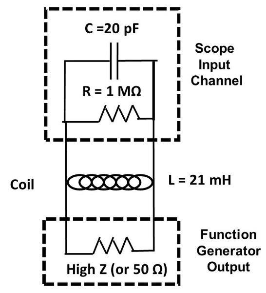

Finally, the last jpeg, schematic.jpg. Do I have this schematic correct for the circuit I am working on? No one has mentioned the 20 pF capacitor. When is it important? I know that the impedance of a capacitor is 1/(omega*capacitance). As some frequencies of my circuit, it did have impedances on the order of other impedances in my circuit, but the cap did not seem to have any effect. How come?

50R and 10k are reasonably standard load impedances which is why your signak generator provides them as options.
The attenuation (squashing) you are seeing is due to the potential divider effect previously mentioned. The power transferred from source to load is a maximum when source and load impedances match. Eg both 50R or both 10k etc. You should prove this to yourself by looking at how power dissipated in a potential divider circuit.
I should point out that a signal generator doesn't usually have a power amplifier built in. Eg They aren't usually designed to drive very low impedances loads like 4R speakers. The 50R setting is designed to drive 50R coaxial cable. The 10kohm setting is designed to drive things like audio amplifiers that might have a 10kohm input impedance.
At 80khz the impedance of a 21mH inductor will be about...
=2pi*80,000*21*10^-3
=2pi*80*21
=10,000
The 20pf input capacitance of the scope is in parallel with the inductor. Work out the impedance of the capacitor and see how it compares with the 10k impedance of the inductor. Is it much smaller or much bigger?
The approximate factor of two disagreement between calculations and readings is due to ignoring the 50Ω input and output impedances of the test equipment. For instance with the both the generator and 'scope set at 50Ω you have 2-to-1 divider; 50Ω generator impedance and a 50Ω 'scope load. For the frequencies you are usning, I recommend you set the 'scope for high input impedance.
The remaining discrepancies, if below 10%, are likely just experimental errors due to instrument calibrations, limited screen reading resolution, and uncertainty about the exact coil values.

I did prove myself that the Power is a max when the impedances match. Let R_L is the load resistance, I_L the current flowing through the load and V_source the input voltage, and P_L be the power dissipated by the load resistor. This calc is P_L =[(I_L)^2]R_L and then the current through the load, R_L is V_source = (R_L + R_S). Plug I_L into P_L expression, keep R_S constant (resistance of the source), take the derivative of P_L with respect to R_L and solve for R_L. You do, indeed, find that R_L maximizes P_L when it is equal to R_S.
With the impedance of the Cap, Z = 1/(2*Pi*f*C) and you get, for 80,000 Hertz, 100 kOhm for a capacitance of 20pF. This is a lot bigger than the impedance on the inductor at the same frequency. I see why it won't matter much for what I am doing here.
The high impedance setting, is, indeed, best for what I am doing.
Ok, I think I'm all good. I guess the hard part was understanding the electronics inside the scope and FG, but this has all been very useful to me. It was worth it to work through all this in detail. Unless there is anything else I forgot to answer or didn't get right, I thank everyone for their help.
Yes. You asked why the capacitance can be ignored...
If you have a very high impedance in parallel with a very low one the combintion has a very low impedance. So the effect of the large impedance can usually be ignored.
In some cases the capacitance of the scope and the wire from your circuit to the scope does matter. You should look at how a x10 prob can help.
