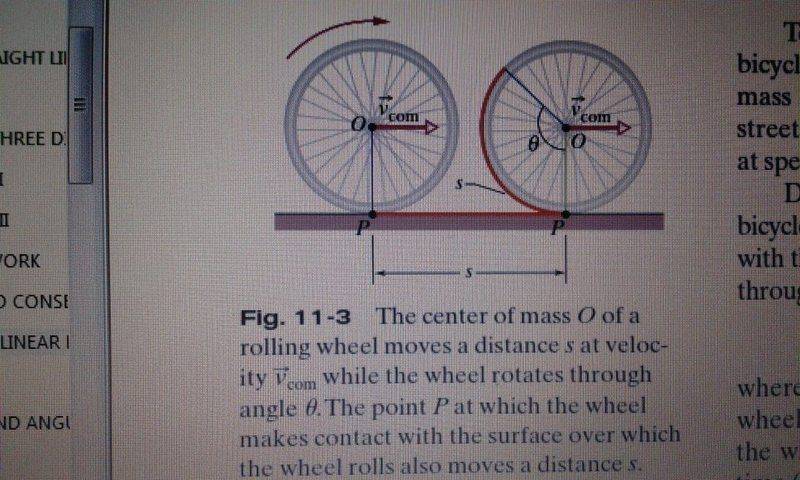

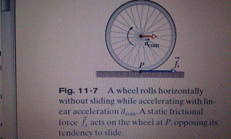

I was really reading the book 'fundamentals of physics'by Halliday,in chapter 11 section 11.4,which is talking about :The forces of Rolling.
But I get confused and that's why I wrote the first post,so I just need more explanation about it.
The first paragraph states:
"If a wheel rolls at constant speed,as in fig 11-3,it has no tendency to slide at the point of contact p,and thus no frictional forces acts there(I didn't get why there is no frictional forces acting in this case).However,if a net force acts on the rolling wheel to speed it up or to slow it,then the net force causes acceleration a→com of the center of mass along the direction of travel,it also cases the wheel to rotate faster and slower,which means it causes an acceleration α.These accelerations tend to make the wheel slide at p(I didn't get this).Thus,a frictional force must act on the wheel at to oppose that tendency(I didn't get this either :p).
If the wheel does not slide,the force is a static frictional force f
s and the motion is smooth rolling.(I didn't get why)
If the wheel does slide when the net force acts on it ,the frictional force is a kinetic frictional force fk. fig 11-3 and another figure are shown below.

There appears to be two contradictory statements The first sentence says if the wheel rolls, there is no frictional force. The next to last statement says if the wheel does not slide, there is a static frictional force. I believe most of us would agree with the second (next to last) sentence.
The first sentence is the first situation that happening in the wheel, that is the wheel is rolling and move with constant speed without any force (Newton's 1st law) and that's means no frictional force, but in the second, there is force in the wheel that makes the wheel move more slower or faster, then that "rolling" wheel will got frictional force.
see there are two types of rolling one is accelerated and other is non accelerated in accelerated a=rα and other is v=rw.
in v=rw relative velocity of pt.of contact with ground is 0 hence no friction force. but force is acting then balance a=rα.
