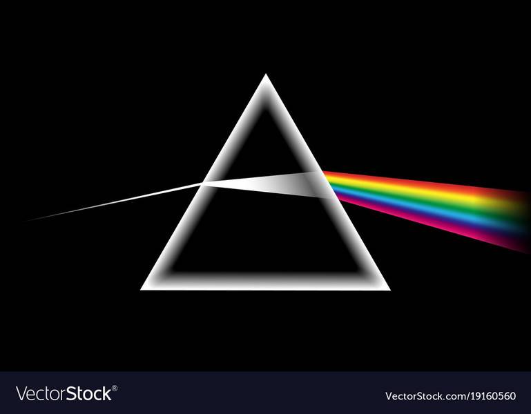

a prism is supposed to scatter light rays and separate it into rainbow,then why in a prism periscope the prism send light rays to a particular direction instead of scattering?

Welcome to the PF. :smile:
What is the difference between how a prism is used in optics like a periscope or image erector, versus how you use the prism to form a rainbow. Hint -- do a Google Images search to see how the prism is used in a periscope, and compare it to this image:
https://www.researchgate.net/profile/Mikael_Sundberg2/publication/277798811/figure/fig10/AS:294333388476423@1447185956597/White-light-incident-on-a-triangular-prism-left-side-disperses-and-creates-a-rainbow.png
Diagram of a triangular glass prism with a white light beam entering from the left and splitting into a rainbow spectrum of red, yellow, green, blue and violet bands on the right.
  • Diagram of a white light beam entering a triangular glass prism from the left and splitting into a rainbow spectrum of red, orange, yellow, green, blue and violet bands exiting on the right, on a black background.

Prisms can be used in more than one way and their angles can be accordingly different.
You will have seen a diagram of this use of a prism. You will notice that light enters and leaves the prism along a Normal. So there is no dispersion there. The internal reflection is arranged to be at an angle, well different from the Critical Angle so all wavelengths are totally reflected.
