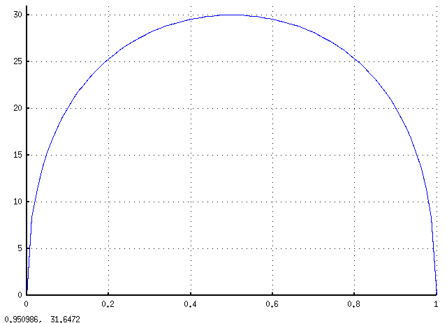

Of course, plotting the function y=arccos(x)-arcsin(1-x) could give a few clues.

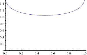

I have a feeling that either (1) the problem is misstated in post #1 OR (2) the teacher has made a mistake.
If I plot the relation to be proved, there is no solution - the there is no value of x that makes the LHS the same as the RHS.

LATER: I took the trouble to plot the function in gnu-octave:
Code:
octave:189> x=0:0.0125:1;
octave:190> y=acos(x)-asin(1-x);
octave:191> plot(x,y*(180/pi))
... the vertical is the resultant angle and the horizontal is x. Notice that at no time does the function even get close to 90 degrees.
For x<0 octave gives complex results - so, just checking that is isn't the argument that has to be 90 degrees:
Code:
