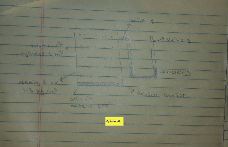

Hi,
The air pressure at the surface is about 1,00,000 N/m2.
It means that on average, a virtual column of air one square meter [m2] in cross-section, measured from sea level to the top of the Earth's atmosphere, has a mass of about 10,000 kilograms and weight of about 1,00,000 Newtons. That weight (across one square meter) is a pressure of 1,00,000 N/m2.
Let's look at the air molecules in that virtual column of air. Let's imagine that the column is closed at one end by Earth's surface where we also have a pressure sensor and the other end at the top of Earth's atmosphere by some other material. At any instant only a fraction of molecules will be hitting the bottom of Earth's surface downward, some of them will be hitting the other end upward, some of them will be hitting the column laterally and others will be in the space between the column of box.
Although at any instant only a fraction of molecules will be hitting the bottom of Earth's surface downward, the pressure sensor will still read 1,00,000 N/m because the molecules strike the bottom of the column more frequently and harder than the top of the column. The sum total of the greater number of collisions and the greater strength of the collisions will be that the average force against the bottom will be 1,00,000 N.

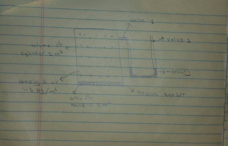

Please have a look on the attachment.
The cylinder is filled with air having the mass of 1.2 kg. Please also notice that at 25 C° the density of air at sea level could also be taken to be 1.2 kg/m3. The valves 1 and 2 are closed.
When valves 1 and 2 are opened simultaneously what would happen? I think that outside air pressure will press the mercury downward because outside air pressure is greater than that of the cylinder. What do you think? Thank you for your help.
As I understand it, you have arranged for a cylinder with a volume of 1m3 containing 1.2 kg air at a reasonable temperature. You note that the density of air in the cylinder matches the density of air at sea level. Why would you not then conclude that the pressure of air in the cylinder will match the pressure of air at sea level?
Have you ever been exposed to the ideal gas law: PV=nRT?
Thank you for the reply.
I was expecting this question but was having hard time to phrase my question in my previous post. I'll try my best what is really confusing me and why I think that the pressure should be different. I'll repeat my original post with some addition and changes. Please have a look on the both attachments. We can assume the temperature to be 25 C°.

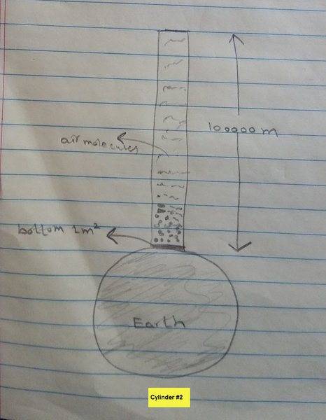

It means that on average a virtual cylinder of air one square meter [m2] in cross-section, measured from sea level to the top of the Earth's atmosphere, has a mass of about 10,000 kilograms and weight of about 1,00,000 Newtons. That weight (across one square meter) constitutes pressure of 1,00,000 N/m2 at the surface of earth.
Please note that the atmosphere becomes thinner and thinner with increasing altitude, with no definite boundary between the atmosphere and outer space. The Kármán line at 100 km is often used as the border between the atmosphere and outer space. Therefore, we can say that the volume of that virtual cylinder is 1,00,000 m x 1 m2 = 1,00,000 m3.
Let's look at the air molecules in that virtual cylinder containing atmospheric air. Let's imagine that the cylinder is closed at both ends - at one end by Earth's surface where we also have a pressure sensor and at the other end, at the top of Earth's atmosphere, by some other material. At any instant only a fraction of molecules will be hitting the bottom of Earth's surface downward, some of them will be hitting the other end where the atmosphere ends, some of them will be hitting the cylinder laterally and others will be in the space between the cylinder.
Although at any instant only a fraction of molecules will be hitting the bottom of Earth's surface downward, the pressure sensor will still read 1,00,000 N/m2. This is interesting because although only a fraction hit the surface, the force still measures 1,00,000 N as if all the molecules are striking the surface. In my opinion, this is what is happening. The molecules strike the bottom of the cylinder, i.e. Earth's surface, more frequently and harder than the top of the cylinder. The sum total of the greater number of collisions and the greater strength of the collisions will still be that the average force against the bottom will be 1,00,000 N.
There are greater number of collisions with the surface of Earth compared to the other end for several reasons. The Earth tries to pull all the air molecules in that cylinder downward toward the ground but as the force of gravity becomes weaker as the distance increases from the surface therefore its pull on the molecules far from the surface is weaker and on the other hand the air molecules also resist this compression due to gravity due to their inter-molecular repulsion and they tend to keep maximum distance from each other, and moreover the molecules have their own independent motion due to their kinetic energy and the molecules which have greater kinetic energy tend to escape the gravity pull toward the surface more easily. But overall the gravity keeps comparatively more air molecules closer to its surface and hence greater number of collisions with the surface of earth.
The striking impact of the individual air molecules with the surface of Earth is more powerful for two reasons. Firstly, each molecule has its own kinetic energy and moreover it's getting pulled by gravity vertically downward which constitutes more force at the instance of impact with the surface. It's just like when you fire a bullet from your roof into a table sitting on the ground - the bullet will have forceful impact with the table compared to a bullet which hits the table along the ground. Secondly, the most important reason is cumulative effect of gained momentum. Let me explain. The bottom of the cylinder, i.e. Earth's surface, is pulling all the air molecules vertically downward. A molecule which is at the top end of the cylinder, where the atmosphere ends, might strike another molecule which is below it and transfer its vertical momentum to that molecule which in turn can transfer its vertical momentum toward the ground to another molecule which is below it and it becomes a domino effect. As a result the molecules closer to the surface of Earth which lie below the majority of the molecules end up with far greater individual momenta. So, the impact of each molecule would be the result of contribution of momentum from many other molecules.
I assume that what I have said above is almost correct.
Question:
How can a cylinder which measures only 1 m3, let's call it Cylinder #1, compared to a cylinder, let's call it Cylinder #2, which has far greater volume of 1,00,000 m3 exert an equal amount of pressure at the surface of earth?Let me try to elaborate more. If you wee to liquefy the air in both cylinders, you would end up with 1.3 kg of liquefied air in one cylinder and in the other virtual cylinder you would end up with 10,000 kilograms. How could 1.3 kg of liquefied air exert same pressure as 10,000 kg?
Yes, I'm familiar with PV=nRT gas law but don't know how to convert 1.3 kg or 10,000 kg into moles.
Mostly correct, but almost completely irrelevant. Pressure is what it is, regardless of whether the air is being pushed down by a 100 mile column of air above or the sealed top of a cylinder above.

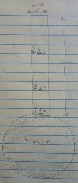

I have few more questions and I would request you to help me.
There is a 1000 m3 rectangular cylinder (1 m2 base x 1000 m length) in vacuum free from gravity. It contains 1300 kg air (density 1.3 kg/m3). In zero gravity, both "top" and "bottom" inside faces are under identical pressure equal to 111,125 N/m2. The pressure will be same along all other faces.
Now the cylinder is put on a planet free from atmosphere with gravitational pull of 10 kg/N. The density of air is adjusted due to gravity in the sense that the air is more dense closer to bottom than at the top. Will the pressure increase only because more number of molecules are striking the bottom per unit time, or is the second reason also being that the molecules striking the bottom with more force? And are both factors equally important?
It is said that pressure acts equally in all directions. I tend to agree with this statement when it comes to gases or liquids in containers ignoring gravity. But when I think of the effect of gravity, it confuses me. Please have a look on the attachment. There are pressure sensors at locations labelled A, A', B, B' and so on. For example, "A" pressure sensor measures the pressure vertically downward and " A' " sensor measures lateral pressure; both A and A' sensors are almost at the same level. The gravity provides an extra momentum to all the molecules only vertically downward and not laterally, therefore sensors A, A' and other sensor pairs should give different readings. What do you say? Where am I going wrong?
Thanks a lot.
Let's consider one air molecule in Earth's atmosphere at 1 km altitude. The molecule must carry the weight of trillion air molecules above it. Here "carry the weight" means to transmit the weight to the next molecule below.
So our molecule punches the molecule below downwards and the molecule above upwards.
Now let's assume the force of the down-punches is the same as the force of the up-punches. The net force on our molecule from other molecules is zero, so the molecule free falls downwards.
Now let's assume the molecule does not fall but floats. We can see that in this case the force of the down-punches must be larger than the force of the up-punches. About one trillionth larger.
