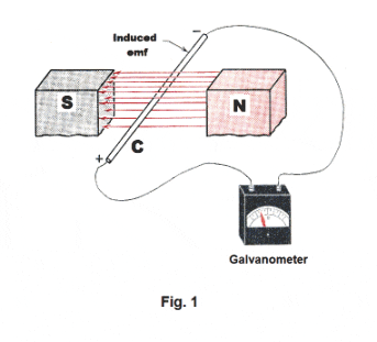

I know the field of electromagnetism is not yet fully clarified but I wonder if there is an idea,theory Why does electromagnetic induction occur only when the conductor cuts the magnetic field lines.
Diagram of a conductor rod labelled C moving across horizontal magnetic field lines between an S pole and an N pole, with an induced emf marked at its top end and a galvanometer connected by wires.

Classical electromagnetism is perfectly well understood in terms of Maxwell's equations. These are over 150 years old.
The magnetic force on a charge depends on its sign, velocity, and the magnetic field it moves through. The force on an individual charge will be perpendicular to both the magnetic field and the direction of motion of the conductor. In order for there to be a driving force in the conductor's direction, both the velocity and the magnetic field must have components perpendicular to the conductor's direction and cannot be parallel. As a result, the conductor will need to cut the magnetic field lines to produce a driving emf.

Using your figure as an example, where would the electrical energy come from if there were found to be induced current and voltage in even the stationary case?

It occurs whenever a magnetic field and an electric conductor move relative to one another so the conductor crosses lines of force in the magnetic field. The current produced by electromagnetic induction is greater when the magnet or coil moves faster, the coil has more turns, or the magnet is stronger.

People have said what happens but not why.
It is an interesting question, because stationary electrons are not attracted by a magnet.
But Maxwell says that a changing magnetic field creates an electric field. This creates an EMF across the ends of the wire, and so moves electrons which form the current.
It does this because it does this!
