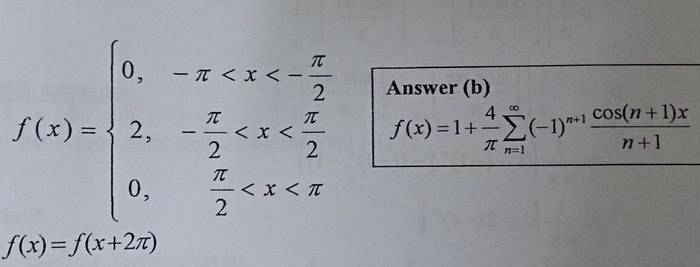

the answer that i get is different with the answer provided , is my answer wrong ? i got ( cos(2n -1) / 2n-1 )instead of ( cos(n+1) / n+1 )

Another test you could try: what happens with the given solution (answer b) when x=π?

Once you have the correct values, plug them in into the Fourier series of answer (b).

So what is the Fourier series of answer (b) for x=π? Does it converge? If so, to what value?
