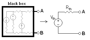

panoramarts
I don't know which node to take as zero voltage. Either C or B or both.
Finding Out I-V characteristic of +V-. Considering Vb = 0.
ASSUMING V IS SOME LOAD
I = I2 - I3
I = ((Va - Vd)/10) - ((Vc - Vb)/10)
I = ((7 - 5)/10) - ((Vc - 0)/10)
I = 0.2 - Vc/10
Where Vc - Vb = V
Considered Vb = 0
So Vc = V
Therefore;
I = 0.2 -V/10
However the Correct Answer is:
I = 0.2 - V/5
I am getting Correct current (0.2A when V = 0)
But wrong Rth (Thevenin Resistance) as 10 ohms.
Can someone point me where Iam doing wrong in the method IAM using for
calculating I-v characteristic.
I know other shortcuts methods that give me correct answer but I want
to know what mistake I am doing and how to correct it.
You need to make clear where the current I is flowing. Are you trying to find the open circuit thevenin voltage or the short-circuit current? Because in the diagram, I = I2 - I3 doesn't appear anywhere in both cases. In the open circuit case, I2=I3; in the short circuit case I=I2 since the 10 ohm resistor is shorted.
Lets assume V is some load in the picture above.

Defennder said:
Well how are you calculating Rth from the above?
Using general form of Thevenin Circuit (according to Circuit Diagram):
I = (-V/Rth) + (Vth/Rth)
When I derive my I-V characteristics I compare the two equations.
Since what I calculated is:
I = -V/10 + 0.2
So
Rth = 10
Vth/Rth = I (when V= 0, intersection) = In = 0.2
This is long way of doing and I have been having correct answers for all thevenin circuits I attempted, except this one. I know the shortcuts of getting answers by making open circuits and short circuits. But that's not I am asking here.
I need to find error in my reasoning for I-V characteristic i did at thread#1
No you cannot assume both are at ground potential, otherwise you are already implicitly assuming that V is a short-circuited load.
panoramarts said:
I = I2 - I3
I = 0.2 - Vc/10
Where Vc - Vb = V
Considered Vb = 0
So Vc = V
Your error is here. Vd cannot be 5 unless Vc=Vb=0, which is an invalid assumption unless it is a short-circuit. Instead, let Vd = V+5. That should fix it.

Anyway here is your method "fixed".
I = I2 - I3
*** I = ((7 - 5)/10) - ((Vc - 0)/10) *** eqn in error
*** I = 0.2 - Vc/10
I = (7 - (Vc+5))/10 - Vc/10
I = (7-5)/10 -V/10 -V/10
I = 1/5 - V/5
If I assume Vc = 0, then Vd = 5. And so Vb cannot be equal to zero.
Vab = 7v.
Va = 7 + Vb
I = I2 - I3
I = (Vad/10) - (Vcb/10)
I = Va/10 -5/10 +Vb/10
I = (7 + Vb)/10 -1/2 +Vb/10
I = Vb/5 + 7/10 -1/2
I = Vb/5 + 1/5
where Vb = -V
So
I = -V/5 + 1/5
Thanks! it also works the other way :)
