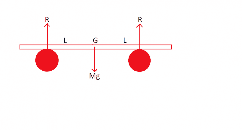

Why does the centre of gravity shift when a rod is displaced?

In the first attachment, the normal reactions are equal. But when the rod is displaced a slight distance x towards the right (second attachment), the normal reactions change to R1 and R2 with R2 being greater than R1. Why is that?
  • Free-body diagram of a horizontal rod resting on two round supports, each with an upward normal reaction R, with the rod's weight Mg acting downward at its centre G, and each support a distance L from G.
  • Free-body diagram of a horizontal rod resting on two red circular supports, with upward reactions R1 on the left and R2 on the right, and weight Mg acting down at centre G. Left distance labelled L+x, right distance labelled L-x.
Hi andy
The plank and the cylinders are in rotational equilibrium . Can you write down the torque equation for the plank about G ? This should give you the answer you are looking for :smile: .
Tanya Sharma said:
Hi andy
Yes it worked. Thanks for that. But is there a qualitative explanation to it too? Something like: The CG shifted which made more mass come on top of one cylinder than the other...? Similarly, is there some qualitative explanation to why the normal reactions are equal when the plank is not displaced?
